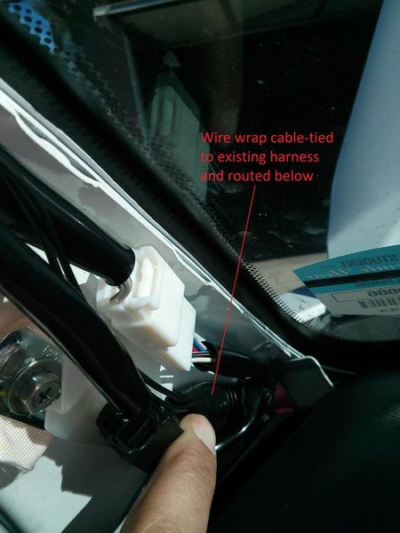

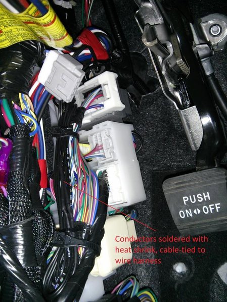

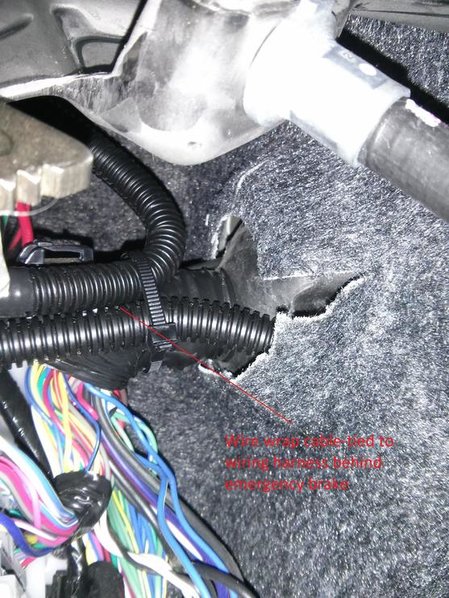

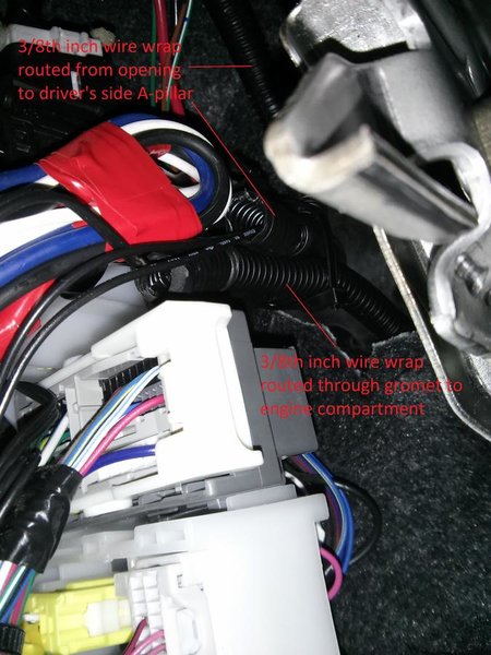

    I decided my next addition would be the auto-dimming homelink mirror with compass/temp display. I ordered the Gentex 453 mirror and kit from RJP869 (Bob Prim, bobsmirrors) and finished the installation today. I followed the write-ups by MustDrive and weendoggy, which made the job super-easy. But I did make one modification, which I thought I'd share.
    The temperature sensor wire wrap length ended up being about a foot short, so I added some in order to protect the conductors between the grommet and the sheet metal through the firewall. But I also added some 3/8th wire wrap to the conductors coming from the mirror between the base of the A-pillar and firewall. See attached pics...
