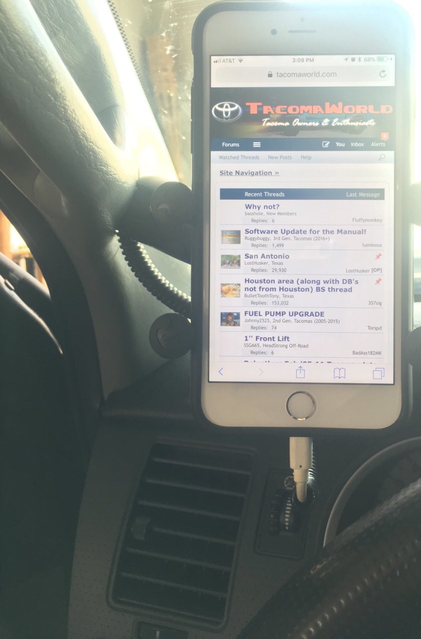

    Just did my 2015 Tacoma Crew Cab. There were zero issues. The only mod to the instructions I did in this thread was to wrap vinyl electrical just beneath the head of the 6mm bolt that holds the ball in the A pillar to take up the slack/loose fit (an 8MM bolt is what comes with the kit and that 8mm bolt fits like a glove, the 6mm bolt kinda rattled around).
    I was able to easily fish the wire path using a straightened coat hanger wire next to the A pillar. Plenty of room to work. I also did my Gentex Compass mirror upgrade at the same time, so having the A Pillar cover off helped in running the power wire for the cell phone and the temperature sensor wires for the mirror.
    The whole install took about two hours from start to stop. I followed the directions in this thread and others and wasn't short any parts that I needed to make the conversion.
    The 12V to 5VC DC adapter I used has two USB slots. I installed it just behind the little fuse box door and zip tied it in place. If the original charging wire ever goes bad or I need to switch between Apple Lightning and USB/C, I have access to the second unused USB port by just popping open the door and the connector is right there.

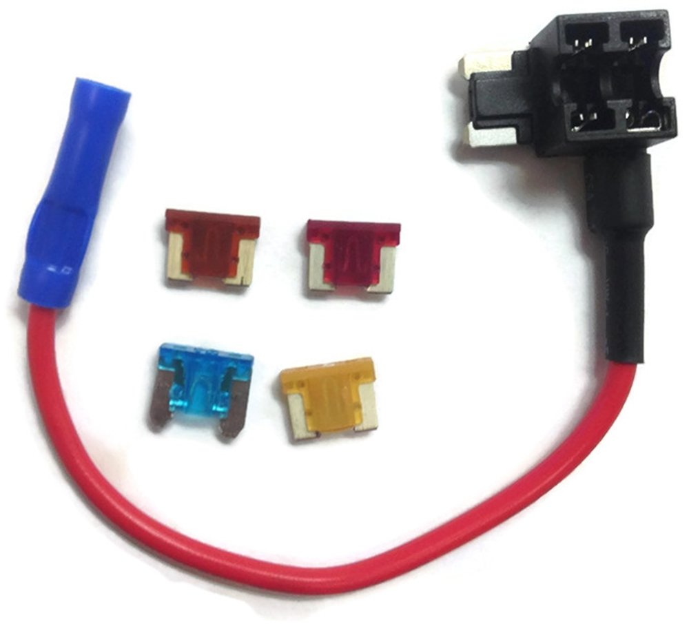

    And the low pro mini fuse tap worked best in my 2015. The other style with the longer legs was an issue as I kept getting intermittent contact on the fuse block. Changing to the low pro mini fuse tap solved the problem. (pictured)
