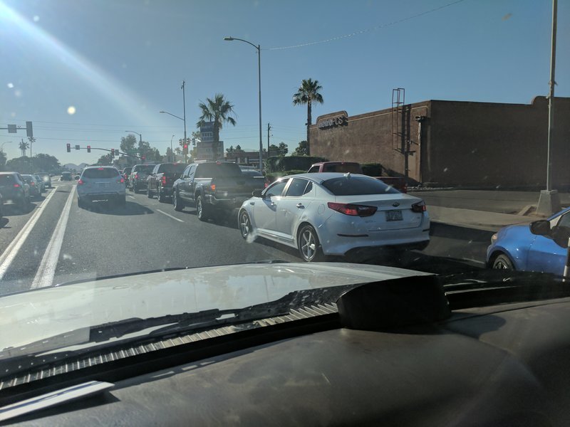

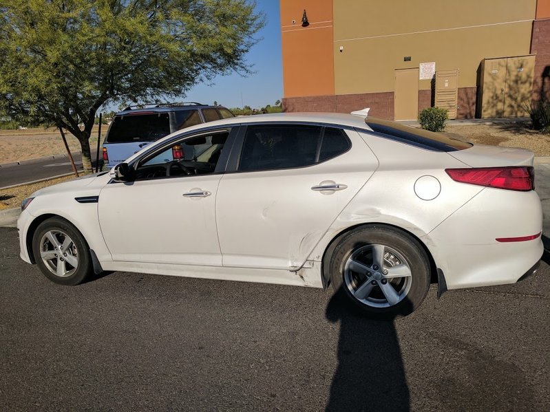

    And someone else tried to cut me off, but merged into me, no video of it, have since upgraded dash cams. Here is a pic? Second pic is of him two weeks later.

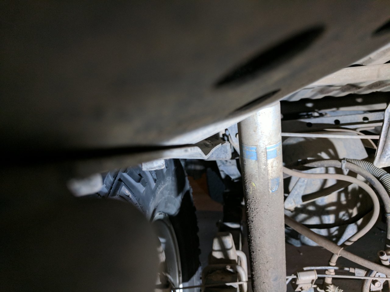

    dude something. I do have some frame damage. Hoping its minor enough I can have it repaired, box in the frame, and forget about it. I even have the frame plates to box it in already. Its just hot.

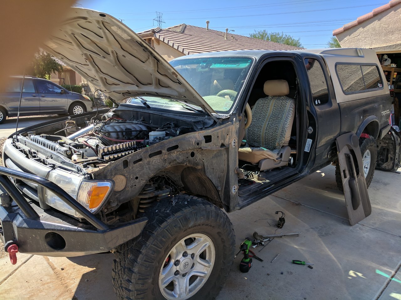

    Got a quote today to straighten the frame, super reasonable and Al at "Al's unibody and frame repair" was a super cool dude who knew his shit. Brought to my attention that I am missing some bed mounts (I cant find on camelback parts so Im gonna have to be that guy and bug gunny).

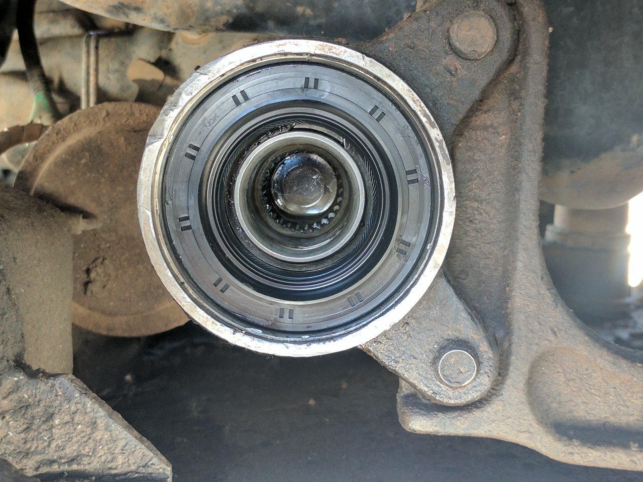

    My front diff is working on grenading itself. I suspect it is related to the "spare" tooth I had stuck to the drain plug when I first bought the truck. Going to get the spare resealed/inspected and maybe a locker.

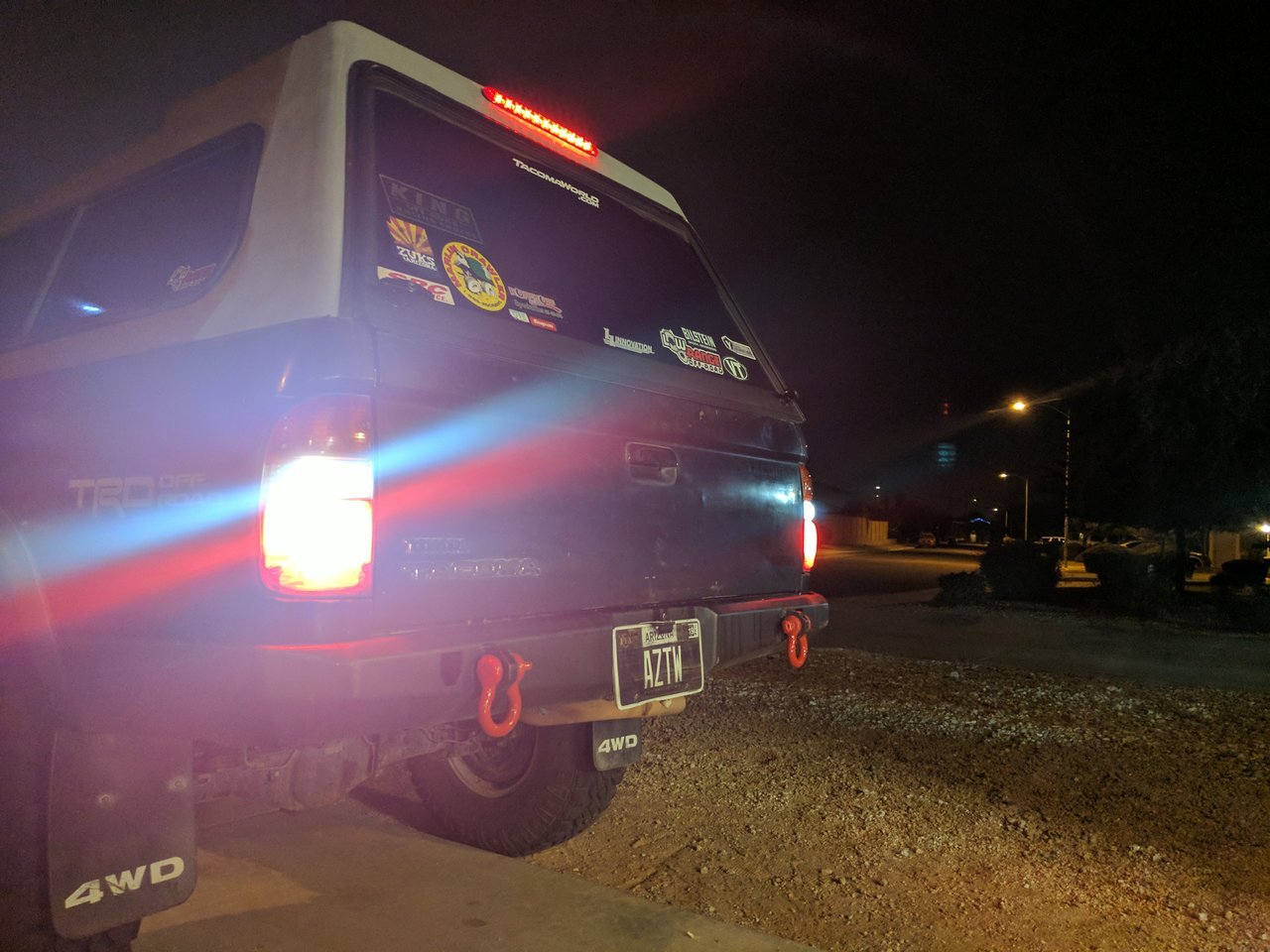

    Updated view of my ass.
