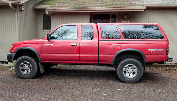

    Hookay, kids, how about a little roll call and update on the state of your springs? Various posts on other threads have asked about settling, so I just went out and measured.
    These measurements are to the very bottom of the plastic fender flares (where they are parallel to the ground) and vertical right over the hub centerline. Mine is of course stock tire size 265/70-16), which is 14.5 from hub to ground. So do the math if you have different tires.
    Right after the install, ended up with 37.25 in the front and 37.75 in the rear, and that was with about 2/3 of a tank of gas.
    Right now, after four months and, oh, about 4,000 miles, they have settled to 37 front and 37.25 rear, and that is with a half-tank of gas. I think they feel just a tad softer. Only a tad. Or maybe just a skosh.
    I am still very happy. With the truck. In general.
