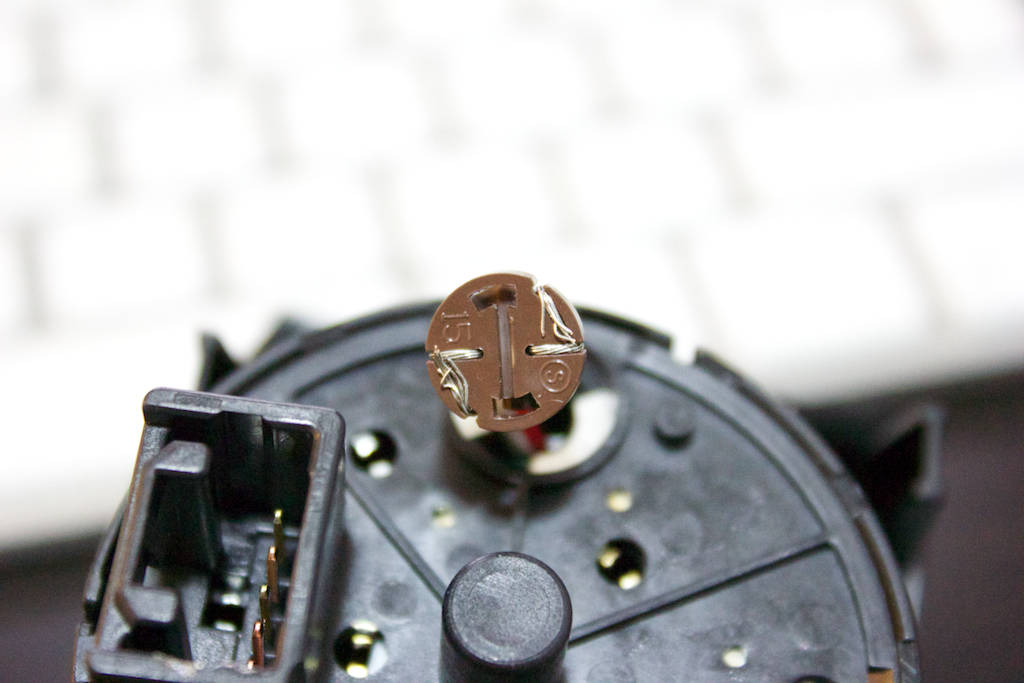

    Sorry for the late reply on this, but I just came back home yesterday after being 10 weeks away for training.
    As I was disassembling the 4x4 switch, I noticed a brown plastic piece was where the wires were supposed to be soldered. Further look at this revealed that this is a light holder. I assume a normal LED light could have been put there, but regardless, the wire plug is still not OEM wired to provide power to this part of the switch. Instead, I tried to run the wires through and twist them around. By putting this light holder back in place, it will force the wires to contact on the circuit, forcing the contact without soldering. a quick test with a 12v source revealed that this works.

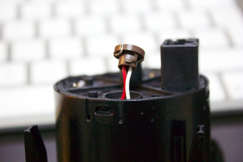

    Just another image of how I ran and twisted the wires through.
    Of course this is the only change to the procedure for me. I still require to connect to the climate control dimmer circuit to make it work in my taco.
    What do you guys think ?

    It is true, the switch was definitely designed to be lit. The connector is just not wired up to support it, like I mentioned in my previous post.
