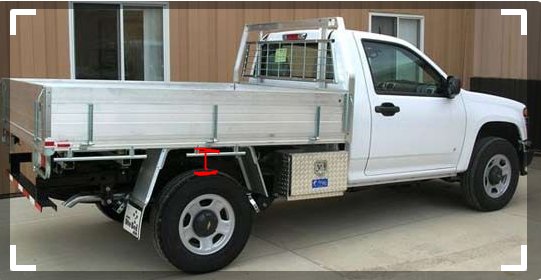

    So your up travel goes higher than the wheel well in your stock bed? How do you currently account for that?
    The entirety of the flatbed is at the top height of the wheel well, so in reality a flatbed is typically around 5-10in taller than a regular bed. You'd have to have some massive wheels to even approach hitting that.

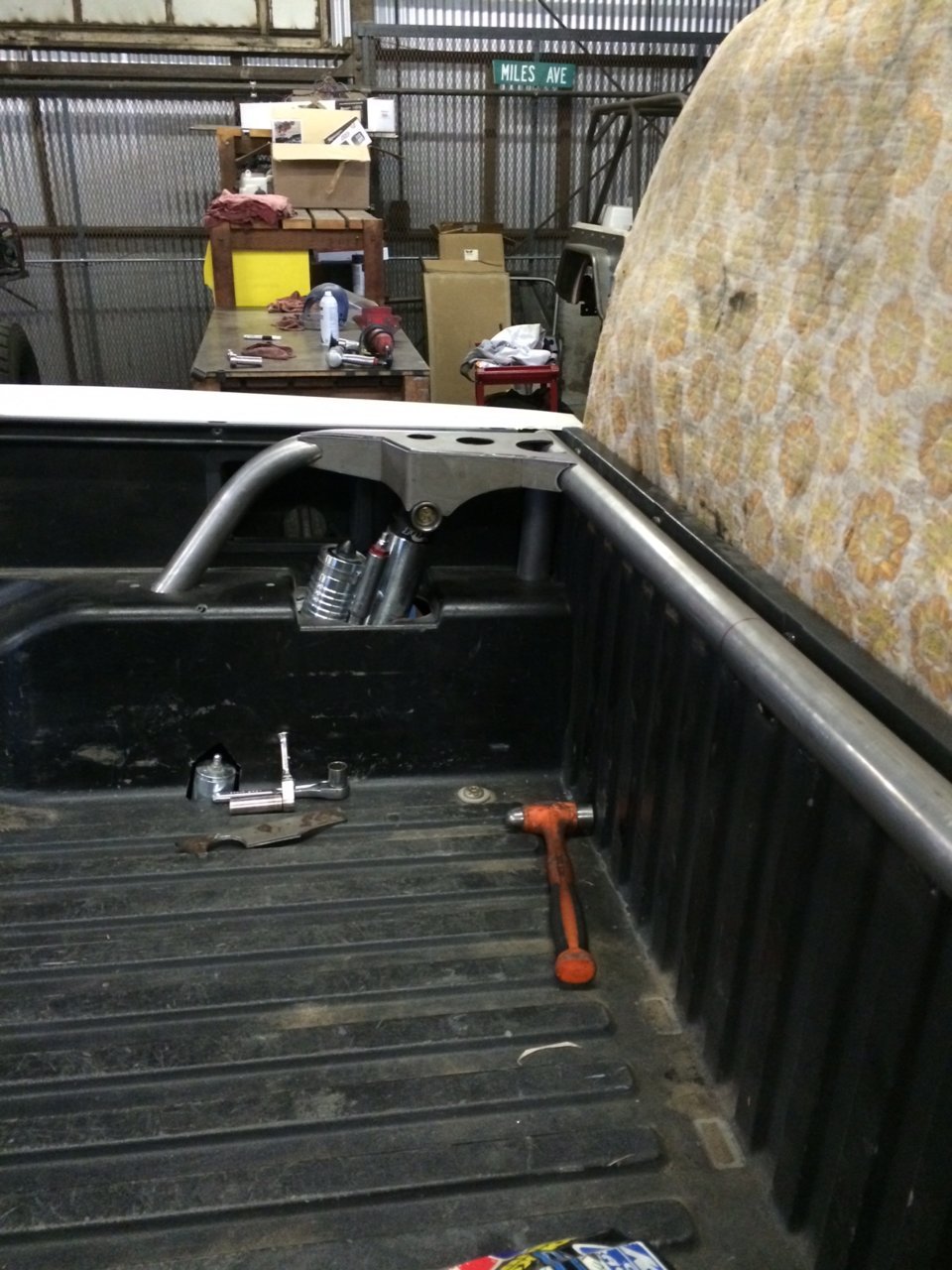

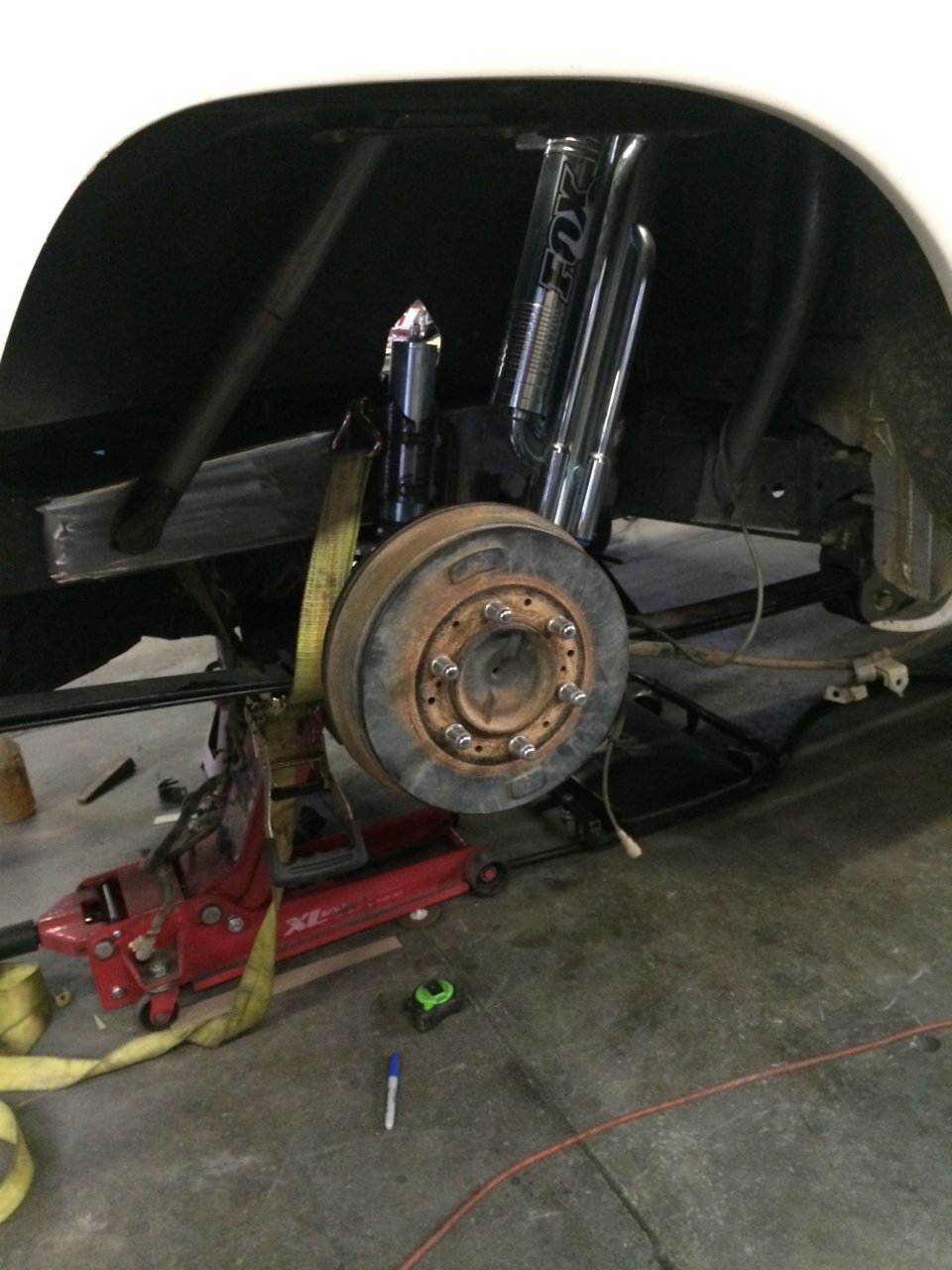

    I have a spring under axle conversion which is why I have more up travel over a stock truck. I also have fiberglass bedsides that bulge out to tuck the tires. Running a flat bed I would still have to cut holes for my shocks and build a new cage (or even reuse the cage I have), but that's easy. I would be more concerned about the tires hitting the bottom of the bed at full compression.
    I could live with having shocks through the bed. I think it would still offer more room over a stock bed. Just not sure if I would have to build small wheel wells that pop up from the bed.

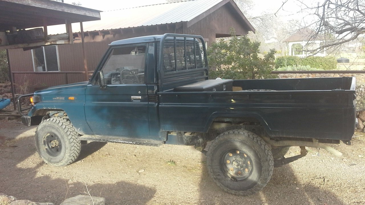

    91 HZJ75, 92 FZJ80
    I wonder if they will make a bed for a 75 series Landcruiser and include it in this group buy, the dimensions are darn near the same as a 6' Tacoma bed.
