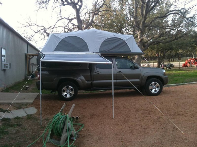

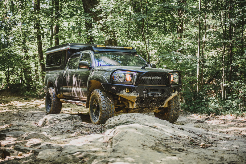

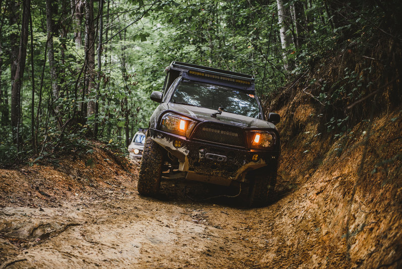

    I've been sorta lurking here for years gleaning little tidbits of information that the rest of you have shared in your threads and posts and have finally decided that it's time to shake all the coin I can off of the proverbial "money tree."
    I've been making mostly moderate changes to the truck over the years while sorting out what I eventually wanted to do with the truck and how to set it up.
    As it sits today.
    As it sat on date of OP.
    FlipPac camper with Fiamma F35 Pro awning on right hand side that I bought from Martyn at Adventure Trailers in Prescott, Arizona.
    Also barely seen are @RelentlessFab bolt-on rock sliders from this group buy.
    Black Diamond Fab / Elusive Elements grill insert from Tim's group buy here on TW. This is the design that he modified with the slot for a light bar and then sold to Rigid. Thankfully Tim was willing to make a few without the "bro-bolts" that you see on all the current models. He even included a custom made Toyota "T" emblem that I still have around here somewhere.
    Using his "behind the grill light bar" that @JLee now creates for us I mounted a pair of IPF 900 XS lights. They work great but the mental midget - that would be myself - that installed them hooked them up to the low-beams instead of the highs. Someday I will get that resolved. Maybe when I see @Blackdawg he will feel sorry for me and show me how to fix it.
    Not shown here is the that I bought from @YotaDan. I know that allot of guys swear by the free DIY mod that is found here to force the bumper driving lights to be on anytime but I really wanted to make sure I didn't create a wire fire by doing it wrong. I really dig the ability to have my high-beams on while traveling on backroads and still have the low-beams lighting up the ditches so I can avoid the deer. I've been able to duck three deer so far with them so I reckon they've paid for themselves.
    I'm an amateur radio operator so I tinkered with a couple antenna mounts and ended up purchasing the @RelentlessFab "Tacoma hood hinge antenna/light mounts" for each side to test out and finding that for me without a bumper to hang antennas off of and the inability to use the roof due to the FlipPac lid that covers the roof when deployed they really are ideal.
    Here it is with a short CB antenna that I used for testing. With the spring installed the antenna can easily be pulled out of the way when lifting the wiper arm to clean the windshield and to bring the FlipPac lid down.
    In the cab I've added sound dampening material from Sound Deadener Showdown. Did the roof on one weekend, the floor and rear cab wall on the next, and the doors on the third weekend. All in all it was pretty easy to do but a bit time consuming because I wanted to make sure I got everything cut as accurate as possible so I did allot of back and forth in and out of the truck. I sincerely appreciate the benefits of this mod since I am partially deaf in one ear as it makes the cab quite comfortable acoustically. No more shouting from my wife when I asked her for the third time to repeat herself because I couldn't hear her.
    And for when I just want music I purchased some door speakers from Crutchfield and the door adapters from *********. I put it all in at the same time I did the sound dampening and it all works great. One thing I regretted though is that I did not source some tweeter adapters so I could upgrade them but thankfully @Unchained 5150 offered up a spare set of Mr. Marv adapters he had and I'm looking forward to receiving them and getting some better tweeters in. Recommendations for ideal tweeters to buy accepted since I really don't know what I should be looking for in features and specs.
    I tried the vent clip phone holders but they annoyed me so I searched TW for alternatives and came up with some interesting solutions. Using their guidance along with a RAM Mounts catalog I made my own and made a thread about it here.
    I was riding with a friend in their FJ Cruiser and ended up focusing on their front sunvisors that are actually bolted above the front doors using what appeared to be the same size handle as our double cabs have over the rear doors. After a part number search I took the plunge and found that they fit perfectly. Created a thread about it here.
    Theres a few other things done but to be honest none of it really amounts to much or I've simply never taken pictures of them so I'll leave it be for now and include them in the updates.
    So what's next?
    My family loves truck camping. We also appreciate being able to get to places that a regular car or two wheel drive truck wouldn't carry us. But as you know even a stock 4x4 Tacoma has some limitations so I've made some purchases to reduce those limitations.
    Right now I'm wrapping up the collecting of parts required to add my lift to the truck. Thanks to the help of @YotaDan at Wheeler's Off-Road I now have almost everything I need.
    Inventory: and an adjusting wrench. in case I do something stupid. (not seen in photo) in the 3.5" - 5" lift variation. have no idea if I will ever use them, the real "impulse" part of the purchase. because I'm simply too damn lazy to source all the parts and make my own.
    Tracy and the crew @allpro hooked me up as well... I also have a 4 Crawler 1" body lift that I purchased in the hopes of reducing some of the metal cutting that I know I'll have to do.
    An extended length brake line set from the @OCTaco group buy thread.
    I'm still waiting on a @RelentlessFab cab mount chop plate kit and trying to not wear out the refresh button on my keyboard hoping for new updates on the bumper I recently ordered that I've been wanting since it first released.
    And today I found and ordered a set of five Cooper Discoverer S/T MAXX in LT315 /70 R17 from Discount Tire Direct.
    In a couple days the truck will go into a local tint shop to get a clear UV blocker film added to the windshield and a Crawldorado hood blackout added as well. Being a geezer has it's downfalls and not being able to see sometimes due to glare is a real ball-ache.
    Now what?
    This is the part that sucks. I have to wait a bit to get the suspension under the truck as I'm also dealing with heaps of medical issues caused by a hereditary kidney disease. Thankfully a few TW guys in my area have stated that they'd like to help which actually has me pretty excited that I might be able to get it all in before October is over. Since I'm pretty much just traveling from home to hospital and back for the next couple months I think I might be able to get away with minimal BFH work for a little bit.
    I know I'm going to trim and thanks to the details and pictures that @la0d0g placed in this thread I feel pretty confident that I can get it sorted out. I was wanting to get the lower flare lip reattached to the trimmed upper flare but after seeing how much frustration others have had that plan is sadly loosing steam.
    I'll keep this thread as current as I can and try to answer any questions that come my way as well. Thanks for reading and for any suggestions

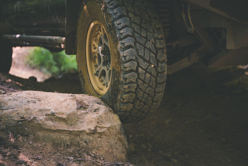

    Wheels & Tires
    Hutchinson Rock Monster #WA-0567 BLACK dual beadlock wheels.
    315/70/17 Cooper Discoverer S/T Maxx all terrain tires.
    Innovative Balancing #DBS-OR8 Dyna beads, 8oz bag per wheel balancing beads.
    No Loss metal valve stem caps.
