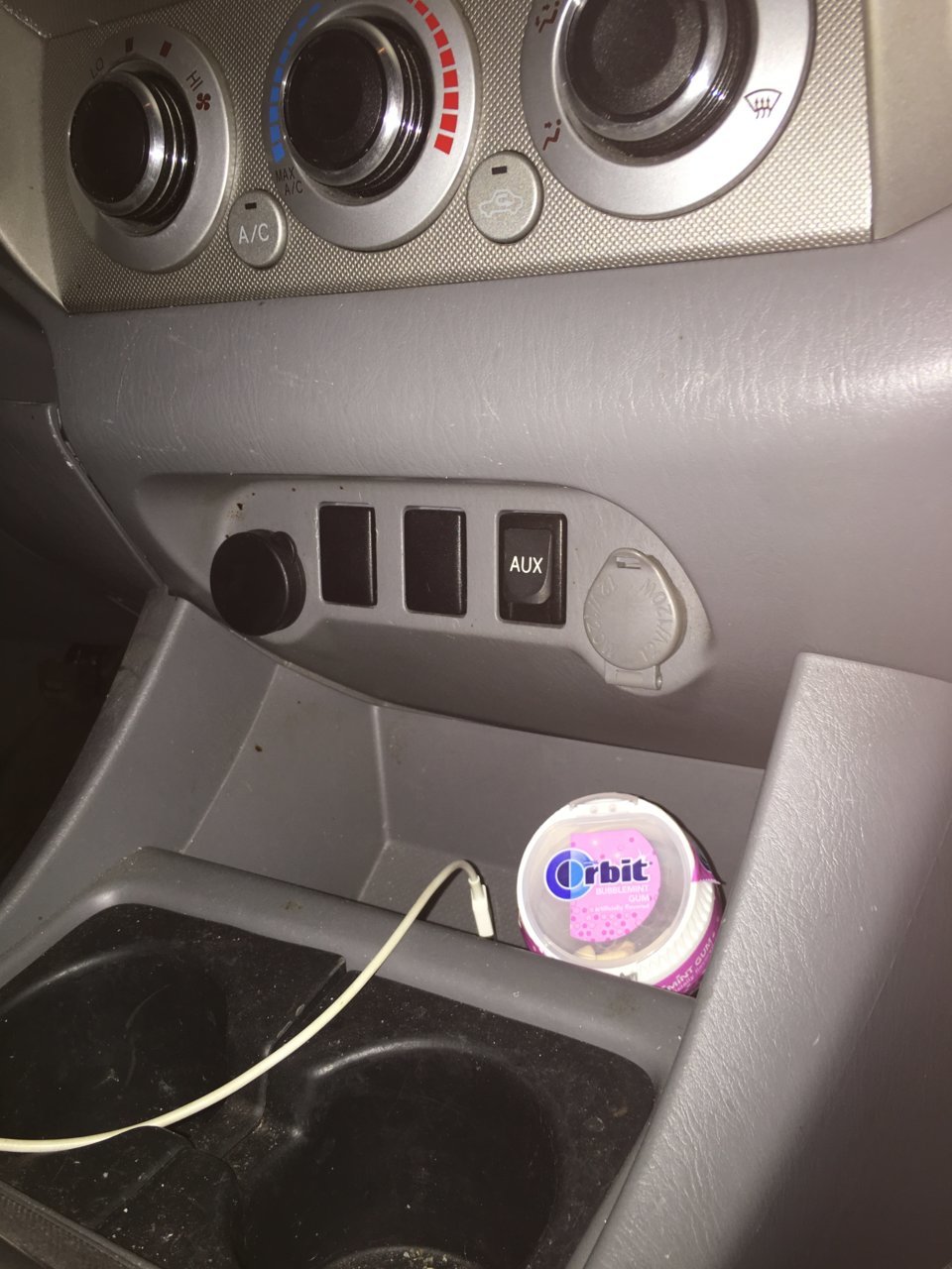

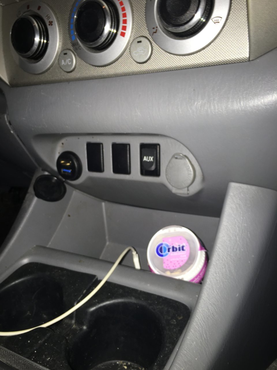

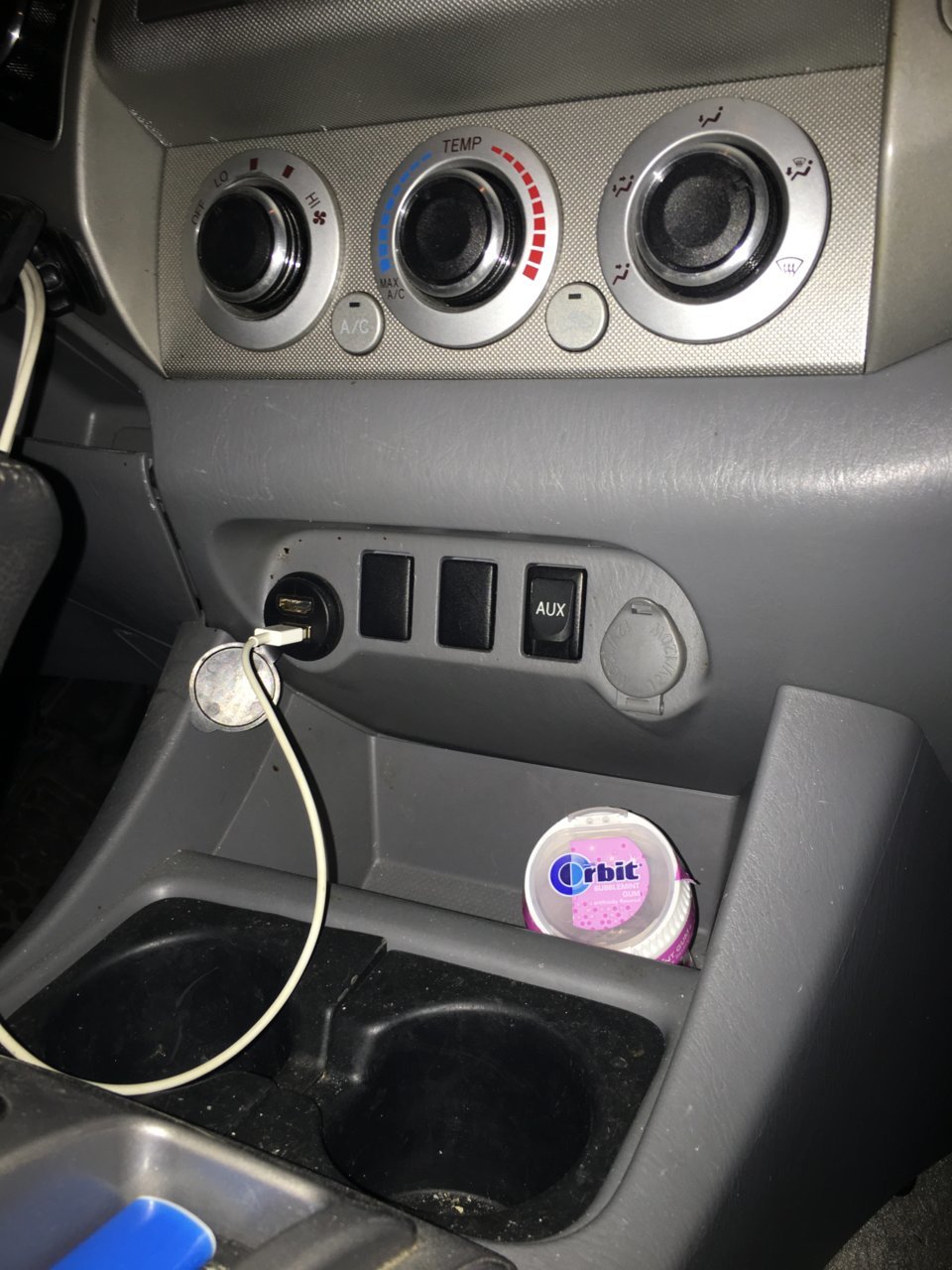

    i got one with a usb and an hdmi output for my head unit, but i could not get my sausage links back there to tighen the nut, all the way, i took one of teh switch blanks out in my automatic to tighten it some, but its still loose. wish i knew how to get that panel off. looks okay, just spins in the hole

    Which panel? The center where the cig lighter sockets are?
    For a 2005 MT:

    Looks basically the same as ours, it wasn't all that hard to get behind that center panel.
    I actually need to do ours again, add a second port and remove the dang cover from the first, it just gets in the way!
