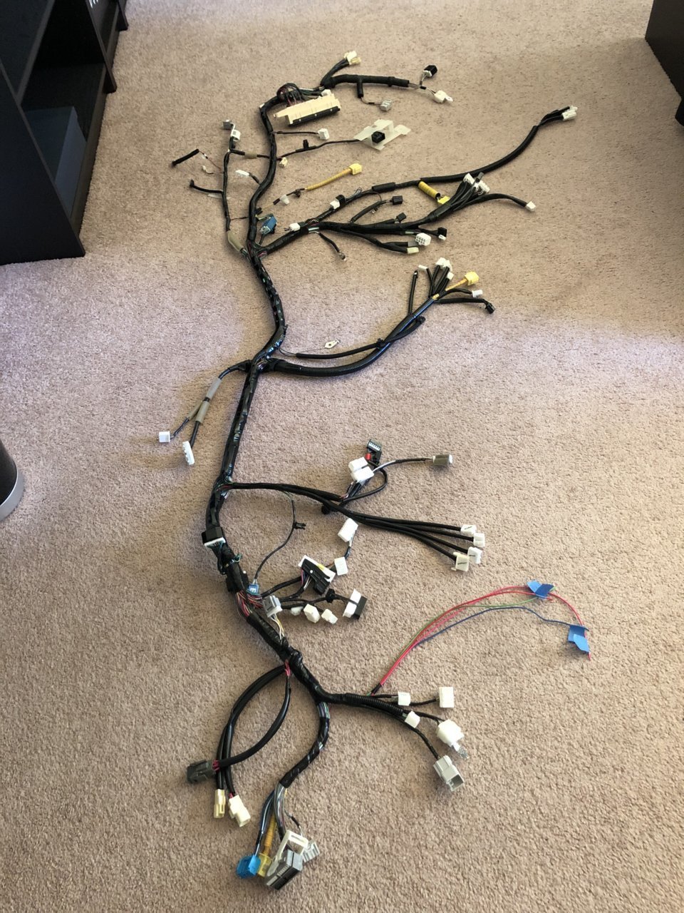

  8. Mar 14, 2022 at 5:52 PM
    #48
    super_white
    super_white [OP] Well-Known Member
    Feb 6, 2012
    #72230
    8,851
    Harry
    Connecticut
    2012 Tacoma 4X4
    Harness ready to be taped.

  9. Mar 14, 2022 at 9:21 PM
    #49
    Zebinator
    Zebinator Well-Known Member
    Nov 30, 2014
    #143381
    931
    Norcal
    06 Tacoma TRD Offroad
    IMPRESSIVE!

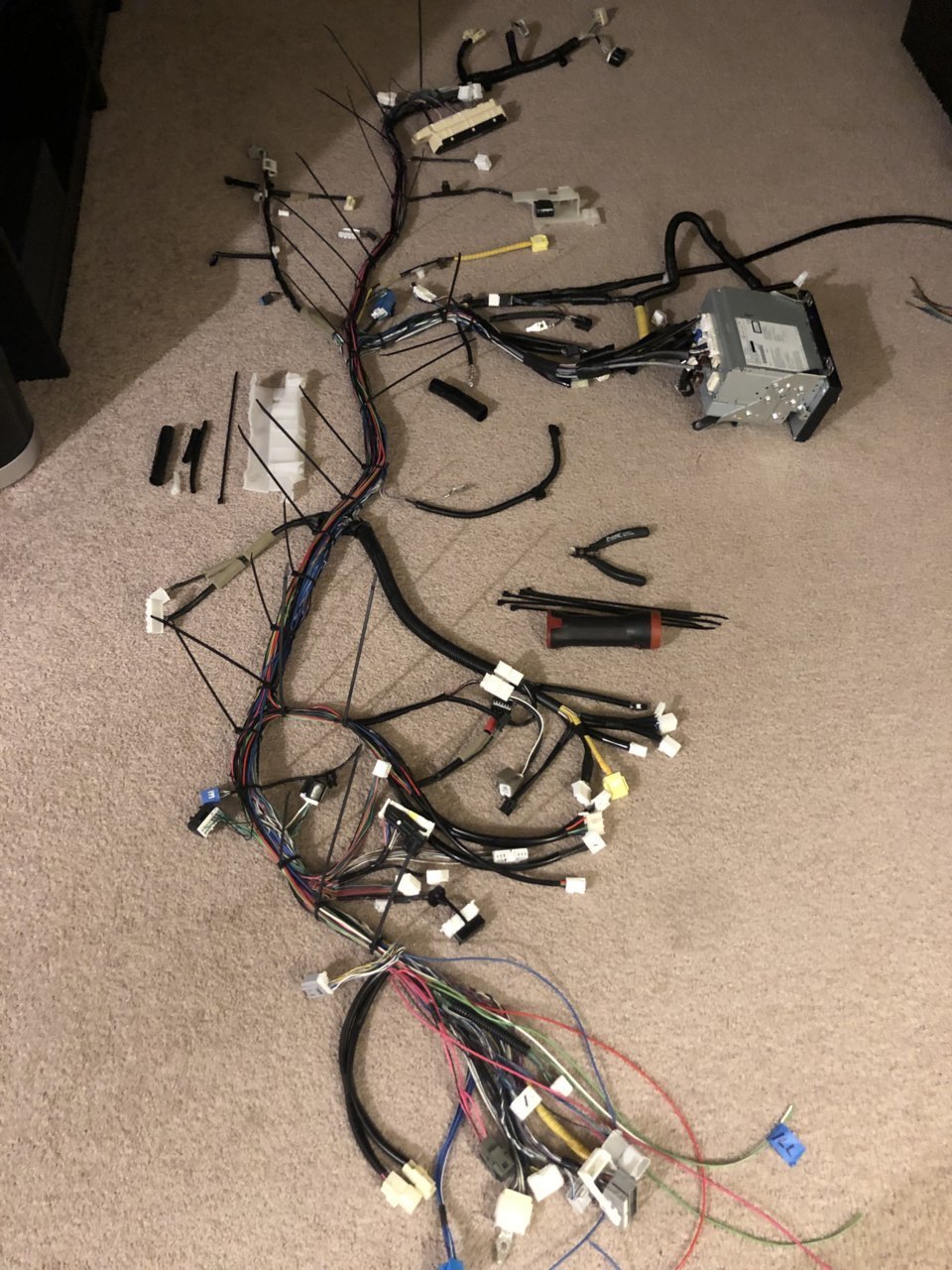

  10. Mar 17, 2022 at 5:01 AM
    #50
    super_white
    Feb 6, 2012
    #72230
    8,851
    Harry
    Connecticut
    2012 Tacoma 4X4
    Modified harness ready to be installed.

  11. Jun 11, 2022 at 6:06 PM
    #51
    Tyler7544
    Tyler7544 Well-Known Member
    Dec 25, 2018
    #276916
    134
    L
    The most unique and special Tacoma
    What is the harness for?
  12. Jun 11, 2022 at 6:24 PM
    #52
    super_white
    Feb 6, 2012
    #72230
    8,851
    Harry
    Connecticut
    2012 Tacoma 4X4
    I have a base model truck and I’m adding fogs, heated/power mirrors, navigation, etc. There are some cut/burnt wires in my current harness so I went to order a replacement and it's not available anymore so I had to order one from a 2013/2014.
    The ECM connectors are different so I had to swap those around and then I added wiring for all the accessories.
