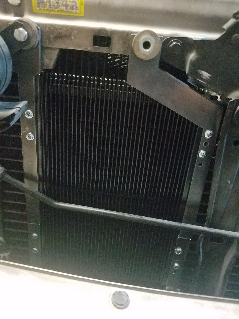

    Just finished installing mine yesterday.

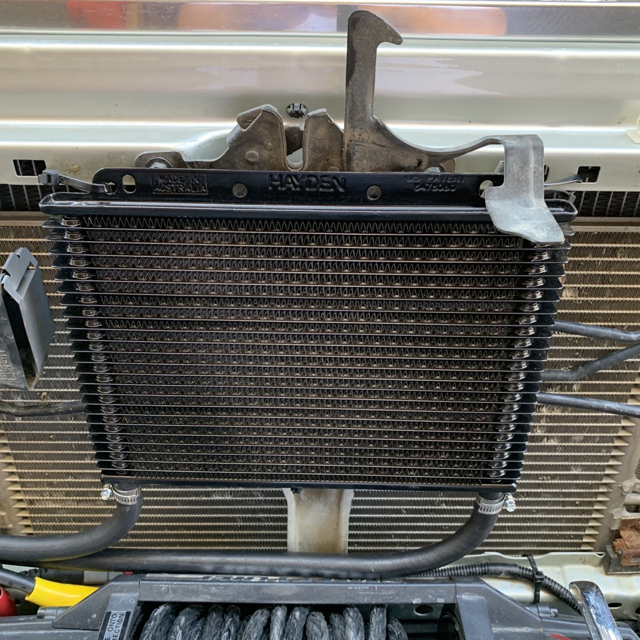

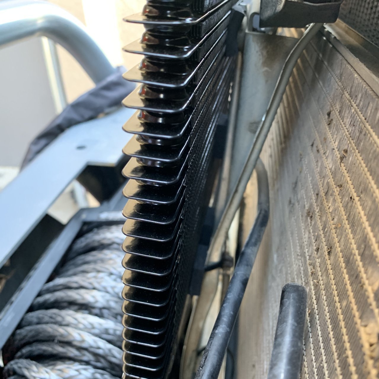

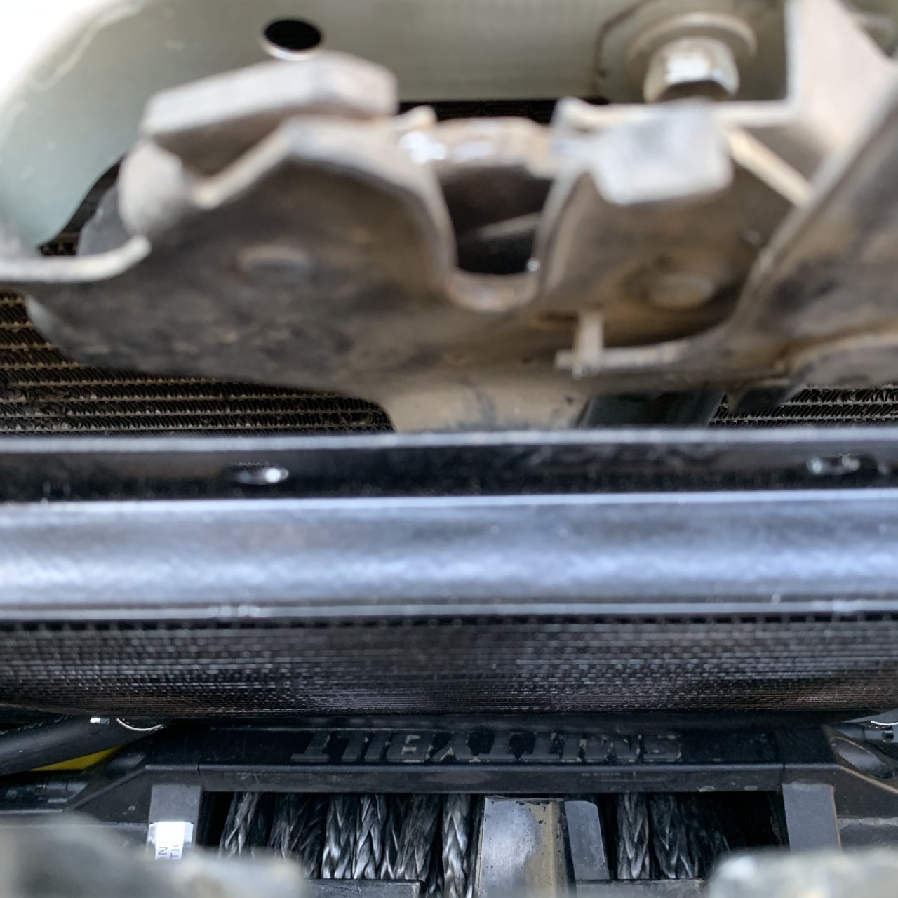

    I know this is an old thread, but can anyone post a picture looking from the top down of the cooler installed? I want to be sure it will have enough clearance behind my winch. The winch has an integrated solenoid, so it comes up taller than the top of a stock bumper.
    Edit: Nevermind. I must have missed that exact photo in the OP. D'oh!

    Lol, it's like I knew you would be asking when I took the pic 9 yrs ago! :D

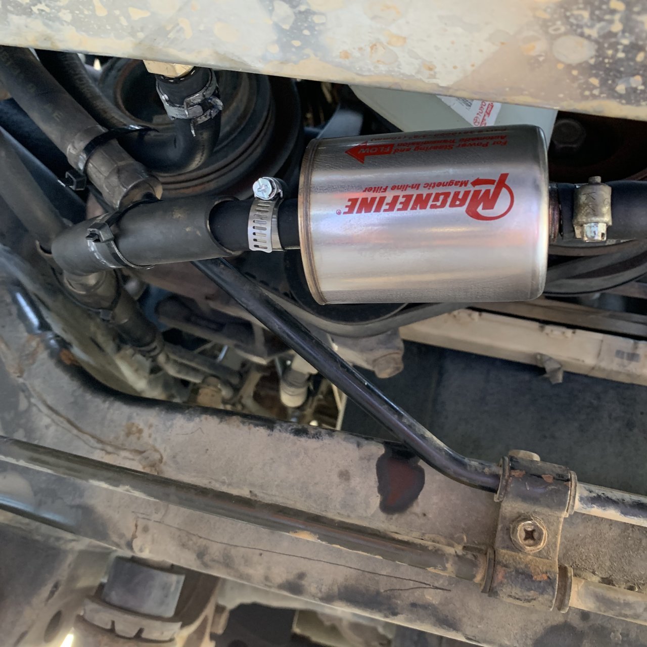

    I actually installed this cooler and used a filter. I mounted my a little different.
    I had to cut off the stock grill mount where it connects to that middle brace. Used the included foam pad and zip tied it to that middle brace. Works great in that space.
    The filter I put it on the returned lined. I bought two new Hayden 106 hose which are 3/8 opening, replacing all of the old ATF hoses.
    Once the grill was back on I fine tuned the position of the cooler so nothing was in contact with it.

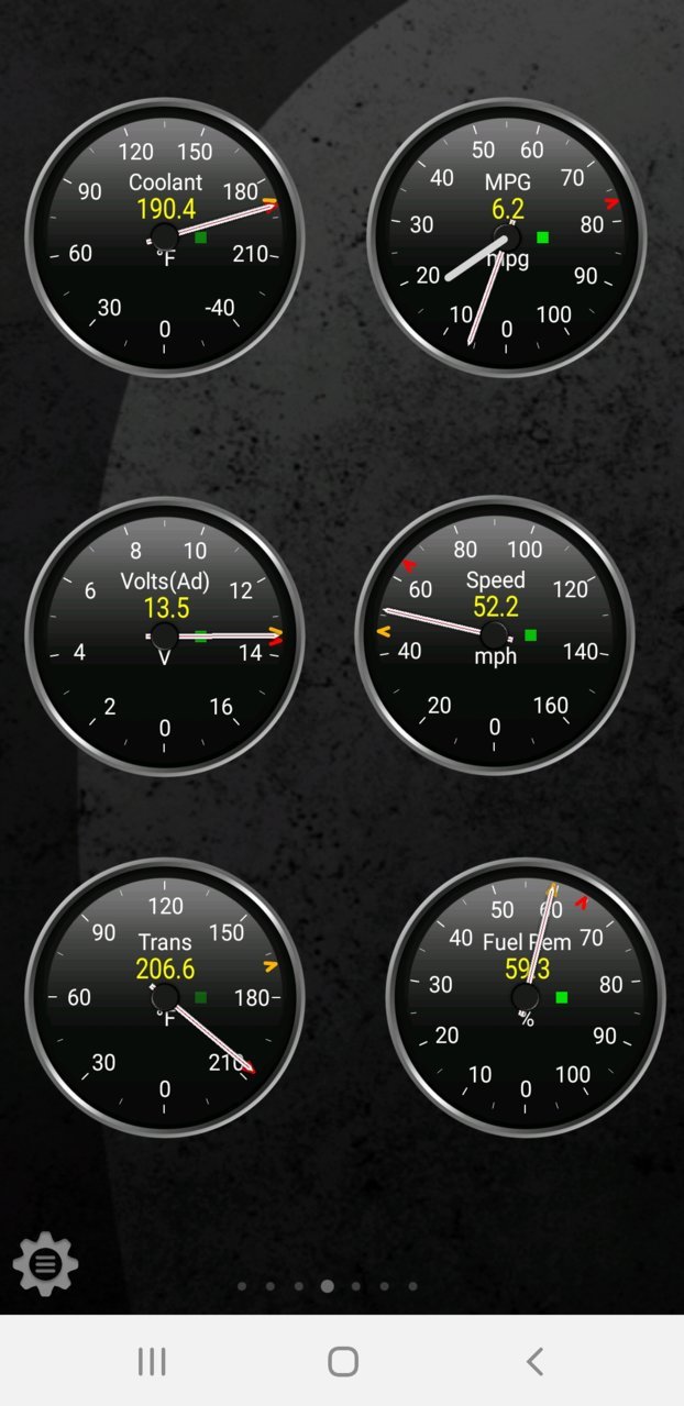

    I recently installed a Long Tru-cool 4454 cooler and completely bypassed the OEM cooler in the radiator. According to my scangauge, the ATF temp is way cooler than ever before, but I fear it's now running too cool and we're not in freezing weather yet. Being summer right now, the highest ATF temp in the mornings is 140 degrees. Then in the afternoon it tops out at 160 on the highway. It gets hotter in stop and go traffic, obviously, but only got as high as 180.
    I've searched multiple threads on tranny coolers and I get mixed answers.
    So if I hook it up inline with the OEM one in the radiator, will it act as a heat exchanger and sort of regulate the ATF temp so it doesn't get too cool or will it just make it worse?

    I would put it inline with the radiator. How long have you drove the truck with just the ATF cooler? Have you done stop and go traffic, freeway, up hill, different times of the day etc to see what your average temps are? 180 doesn’t sound bad to me.
