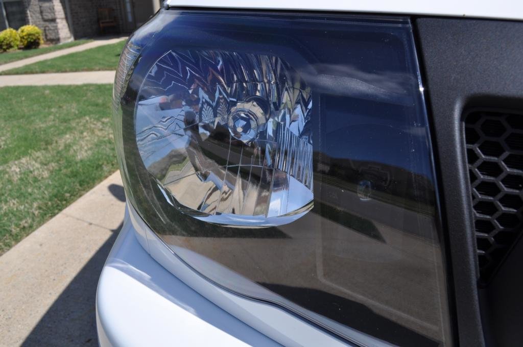

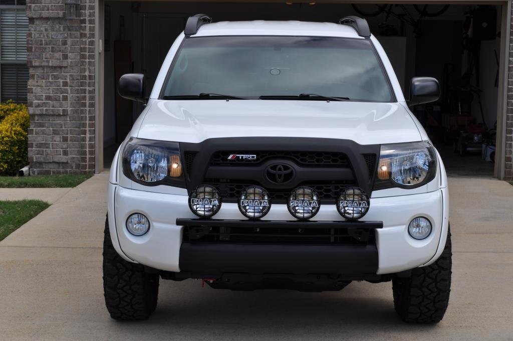

    Thanks for the write up. I did mine a while back when I bought some aftermarket headlights. Then I decided to do the BHLM the same day and now the aftermarket black head lights are just sitting in my office after being on my truck for maybe 2 hours. I'll probably sell them later. Anyway the headlights were easy to get out with no issue.
    BHLM Painted to match the grill and lower valance
    And I think it looks mean as shit without the lens over the DTRLs
