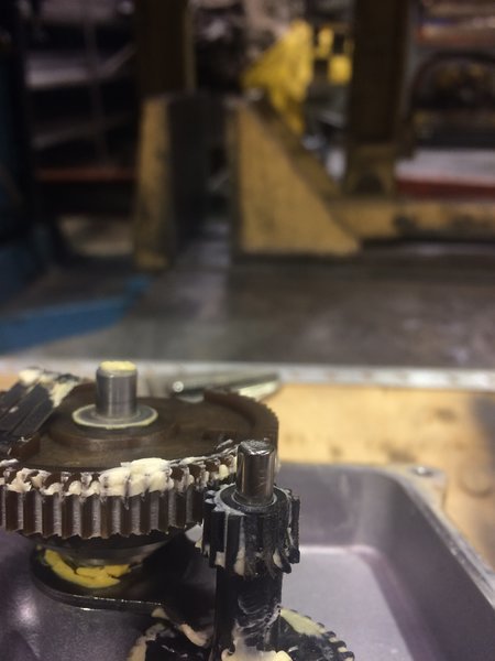

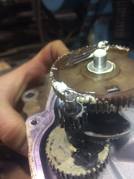

    Well, think i got it. I opened up the front ADD and soldered the known prongs. When I went to reassemble, I noticed the little gear only has half its teeth!
    So I think in reality I actually fixed the motor, because after a few tries it does go into and out of 4wd (dash indicators all normal; off then solid) but it only works every other ish. Which tells me:
    1: I did actually fix the motor which wasn't working.
    2: I need an new ADD anyways because of the broken gear.
    To EBay!!

    With any luck, you might be able to find a broken ADD (i.e., bad electric parts) that still has good gears in it.

    For the $200 on eBay, I'm happy to buy a brand new in box motor and install the new one.
