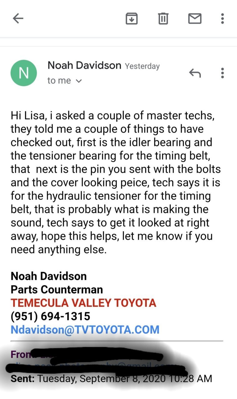

    So UPDATE!! I contacted my local toyota dealership (parts dept.) And confirmed the location of the "extra" mystery parts...

    I'd hardly call that confirmation. The service tech saw timing belt pieces and was like "oh yeah, that's the tensioner and idler parts" and is trying to sell service. We learned nothing new.
    The smallest bolt is for the inner timing cover, timing cover plastic, or used to hold wiring harness / sensor, or dipstick. The larger bolts are probably originals that were replaced with newer ones (you said they broke some bolts). I have the exact bearing/spacer looking thing in my junk drawer when I did my timing belt - not the issue. The plate is not an intricate part of the timing system that would create noise.
    As others have suggested, it could be an accessory or idle pulley which you can test by removing a belt 1 at a time. It could be the aftermarket steering pump.
    If you can take out a dash cluster and replace the bulbs, I'm sure you also have the ability to put remove the upper timing cover and use a screwdriver on a pulley to find out where a sound is coming from.
    If your truck takes "quite a beating" and you drive it rough off-road, I'm not sure a pulley noise could be a concern for you at this point -- especially to drop money on 1 or 2 more mechanics to diagnose & repair something that could be done yourself.
    I'd recommend you spend 1-2 hours on YouTube and familiarize yourself with the timing-belt replacement process, you could have identified all those pieces yourself, fairly easily.
    You are investing a lot of time making videos and posts online, when you could have been diagnosing or fixing the problem yourself.
    There are many moving parts on an engine that make sounds, as you have discovered, nobody online can tell you exactly what the problem is and be correct the first time. But it appears you have ignored some simple recommendations from people here, as well.
    At the end of the day, it is your truck and you do what you want to with it. It could be one of the bearings in the new tensioner / idler pulley is bad, or the initial replacement is screwed up, and you'll have to have those components replaced again for a huge pocket of cash. But if the engine is running fine & timing is correct, that leaves it pretty unlikely . There is the flat washer between the tensioner pulley & block that is sometimes forgotten.
