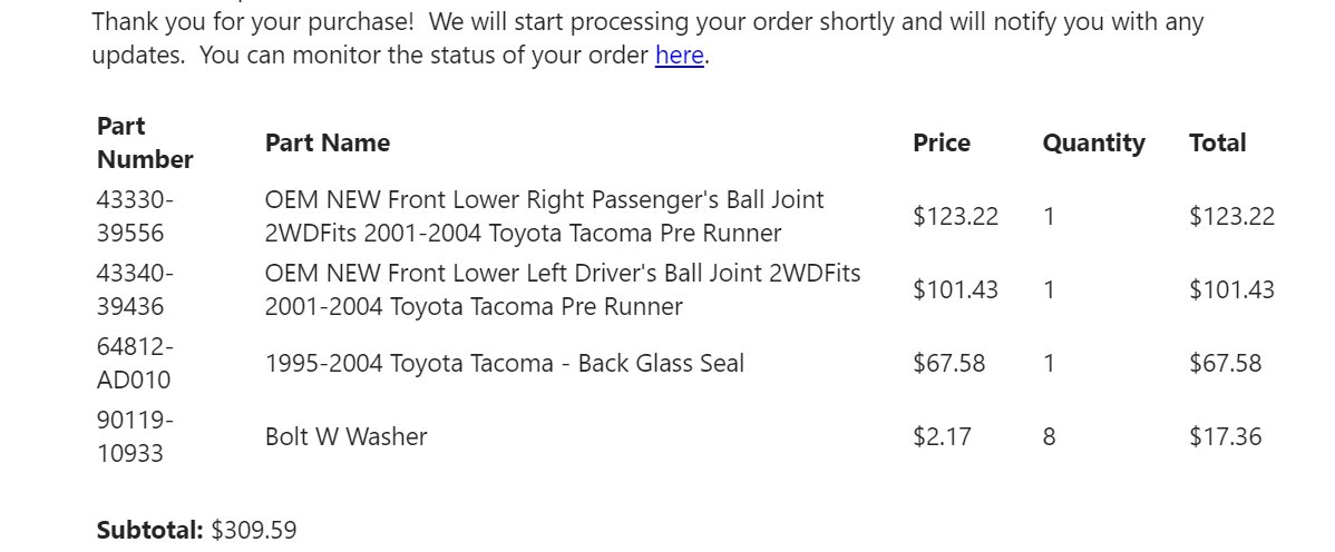

    I made this same order last night, see below for my part #'s. This includes the bolts. Total cost was about $240 before shipping. Ignore the back glass seal obviously!
