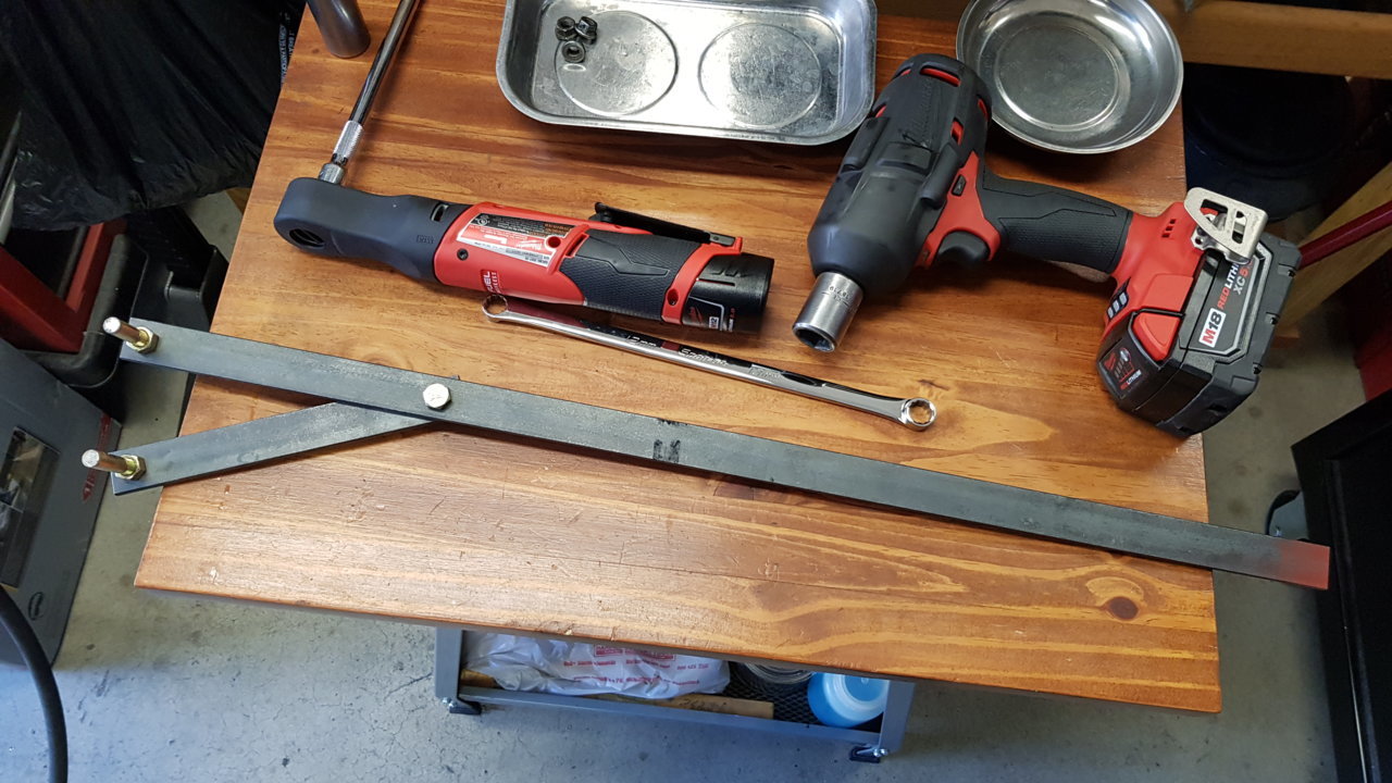

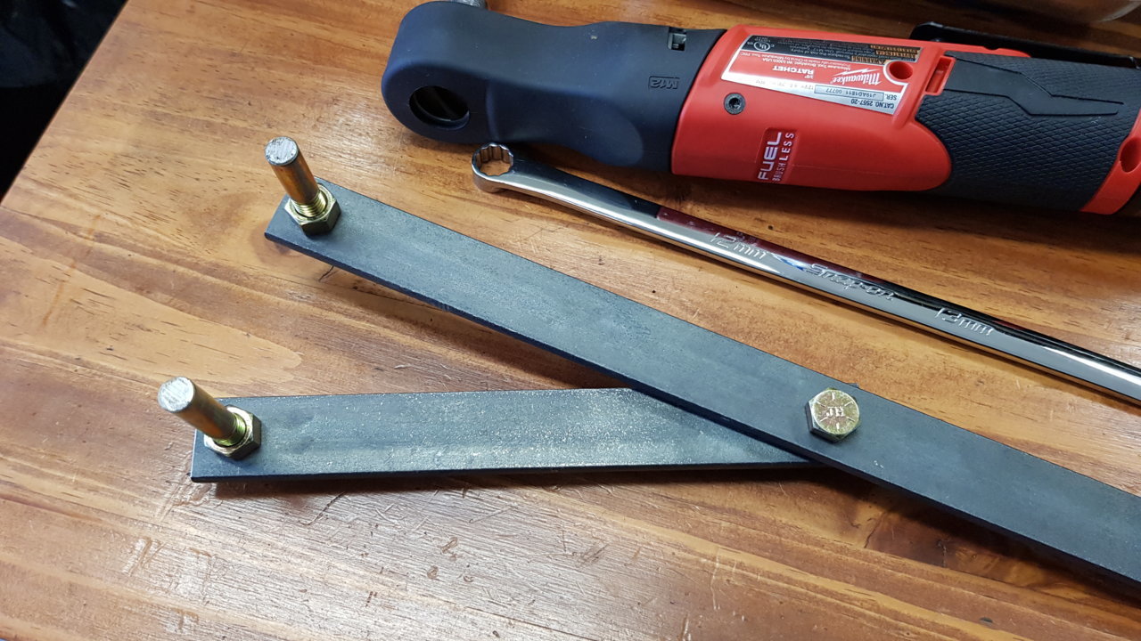

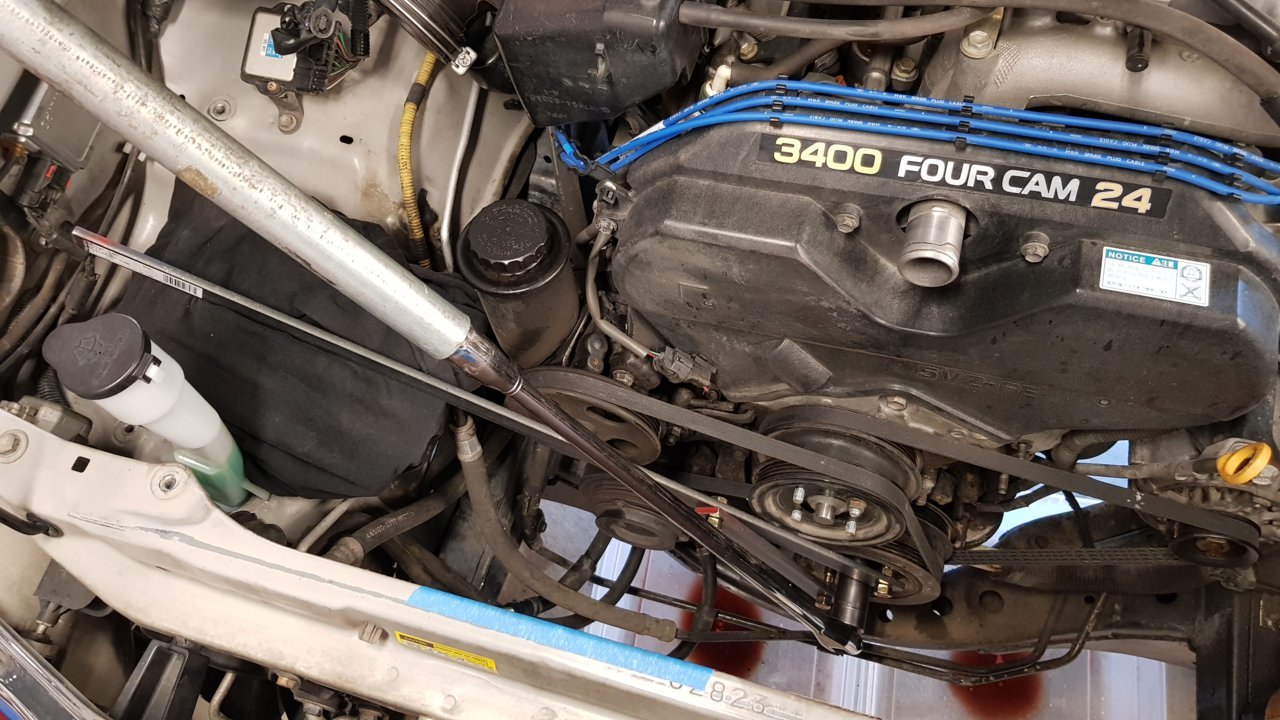

    First 2 times I did my timing belt a lot of swearing etc. I tried the starter bump and it broke my breaker bar!
    Anyhow, I finally made a tool like the one pictured - I had everything on hand and took me 20 mins. All you need is flat steel stock from the home center, drill the center hole as pictured. The hole really only has to be large enough to fit a 1/2" extension if you dont have ability to drill a large hole (I assume would need a step bit). Then 2 additional holes for the bolts (forgot spacing but its an even inch number, see the thread) and jam nut those to the bar. Just make sure bar stock is flat against the pulley or bolts will bend.
    My floor jack handle fits over my breaker bar but if not get some steel pipe.
    Also does not hurt to hit it with some penetrating oil - I struggled all day once using transmission as a brake on the pulley and finally gave up, sprayed it overnight and next day came right off. But this rarely works.
    The bar is really easy and about $10 or so in parts. I was really stupid for not doing this right from the beginning but like a lot of people I was penny wise, pound stupid at the time. You need sharp drill bits to make it through the steel and I have learned to use cutting fluid to avoid ruining my drill bits.
    I looked it up, bolt spacing is 3" from what someone reported but check before committing. Also you need bolts that are threaded all the way to head, might have to go to ACE or similar to find those. Forgot the size...
