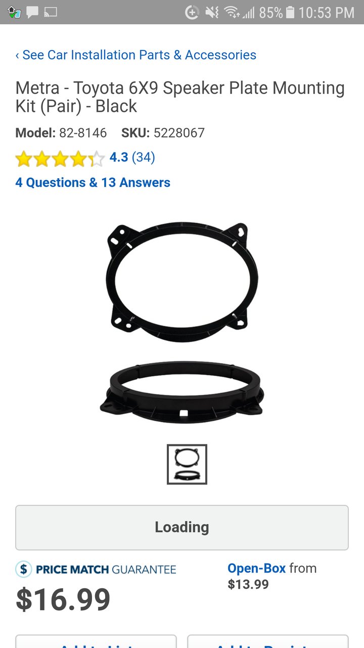

    Yes, I should have took pics once I installed. I got an adapter off of Amazon, 1.5" hole for the tweeters I got.
    The mids mount into an adapter, the Metra adapter is noted in my post
    Edit:
    These are the 1.5" tweeter adapters
    www.amazon.com/gp/product/B01MQLHT0S/

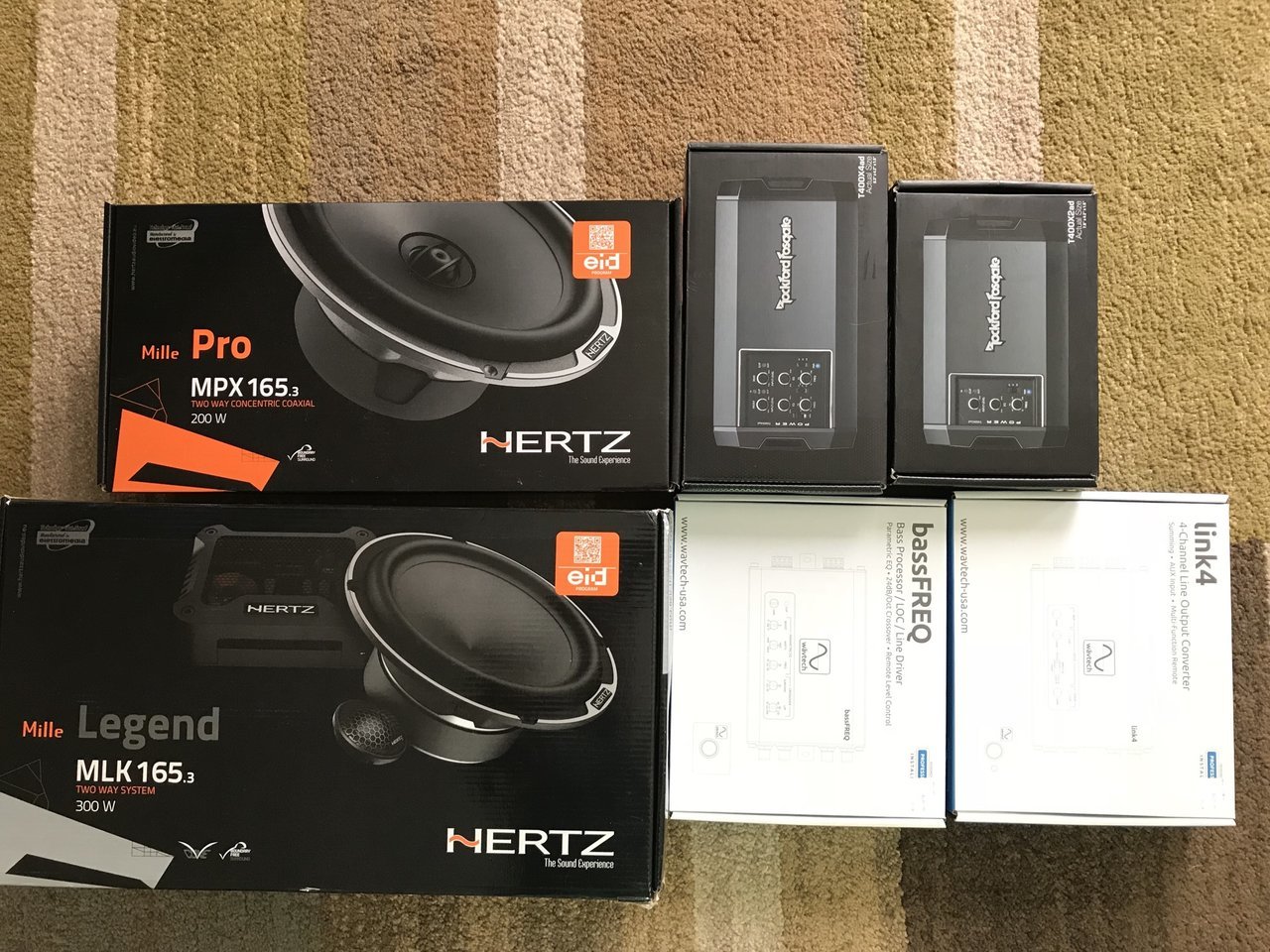

    For that exact speaker? I mentioned in first post???
    Picked up these today in mail. Just waiting on the plug adapters now.
