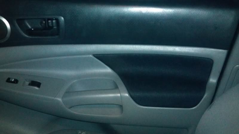

    Wet Okole Arm Rests - (Thanks RAY & ManWithoutAPlan)

    Haha. Hope your Horns are scaring the shit out of people. lol Thanks man.

    me and ray did some good work :D

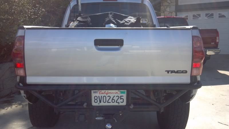

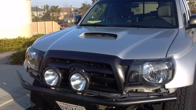

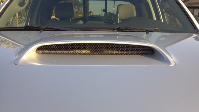

    Opened up the scoop to let air in. (mostly to make it less fake)

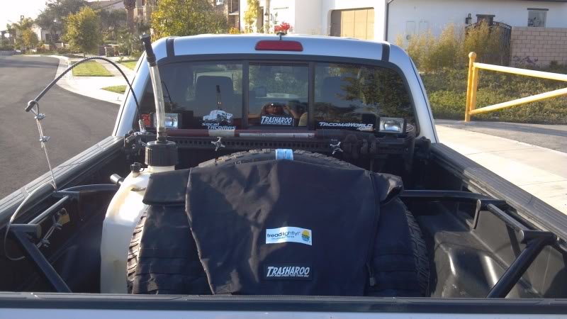

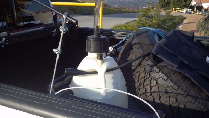

    Picked up my Trasharoo
    Made a tie down for my CB antenna for when I enter parking structures.

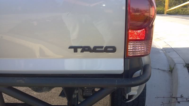

    Got bored and added my old Taco logo to the tailgate.

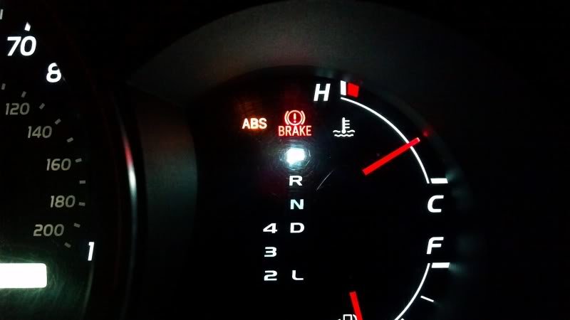

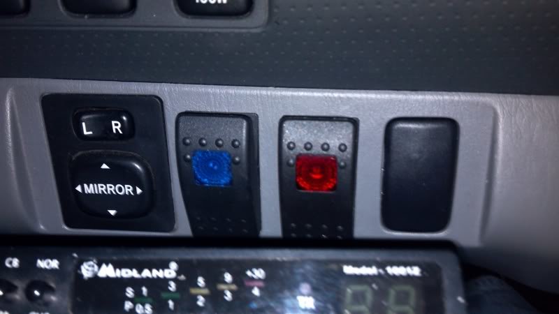

    ABS Bypass Mod (Red Switch)

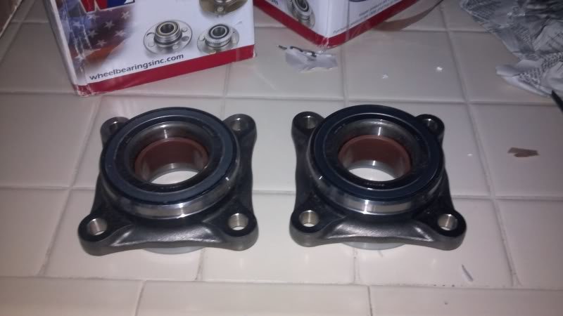

    Cant wait to install these puppies (Wheel Bearings)
  16. Feb 23, 2012 at 9:53 PM
    #336
    rcfreak201
    rcfreak201 Well-Known Member
    Jul 24, 2010
    #40660
    6,064
    Hmm so now you'll be able to stop in the dirt. I wanna do this mod, got a link or some info hiatt?:)

    That Wasn't so hard to do...lol. Now I know how to wire it all ;)

    http://www.tacomaworld.com/forum/2n...comas-w-o-vsc-locking-diff-write-up-pics.html
    Just make sure that when you cut the wire, follow the wire to the hole by the firewall on the driver side of the engine bay. This way you dont have to run long wires all the way across from the passenger side and it looks better. Also, to turn ABS back on, you need to restart the truck so the computer can read that its on. I didnt really care because Id never need to switch abs on and off on the fly, just off when i need too.
