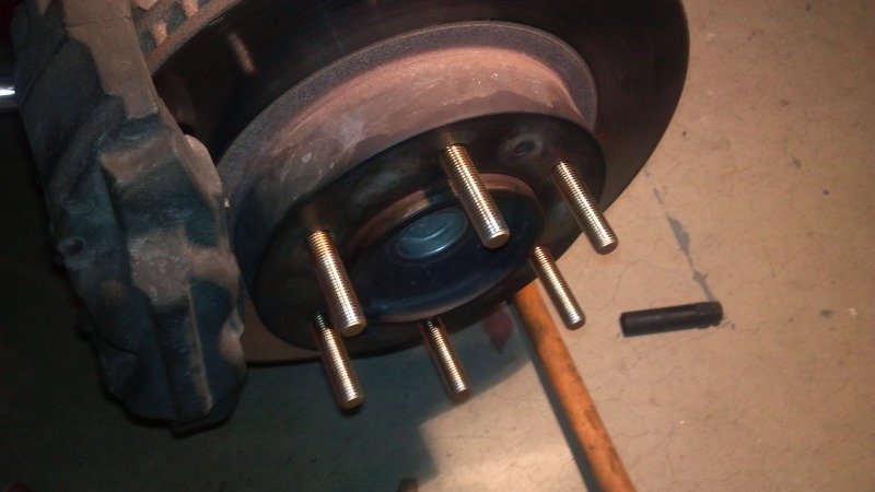

    Since I have been getting a lot of PMs about this lately, here is the info on the ARP race lug studs:
    ARP Wheel Studs
    part number: ARP#070-100-7715
    This is where I ordered mine.
    http://www.jegs.com/i/ARP/070/100-77...oductId=747558
    You will need 3 sets for the front because they sell them in packages of 5. I had to run a 1/4" wheel spacer because my extended thread Gorilla Lug Nuts would bottom out. You could go my route or buy some open end lug nuts. 12mmx1.5 is the size for our trucks. STOCK LUG NUTS WONT WORK

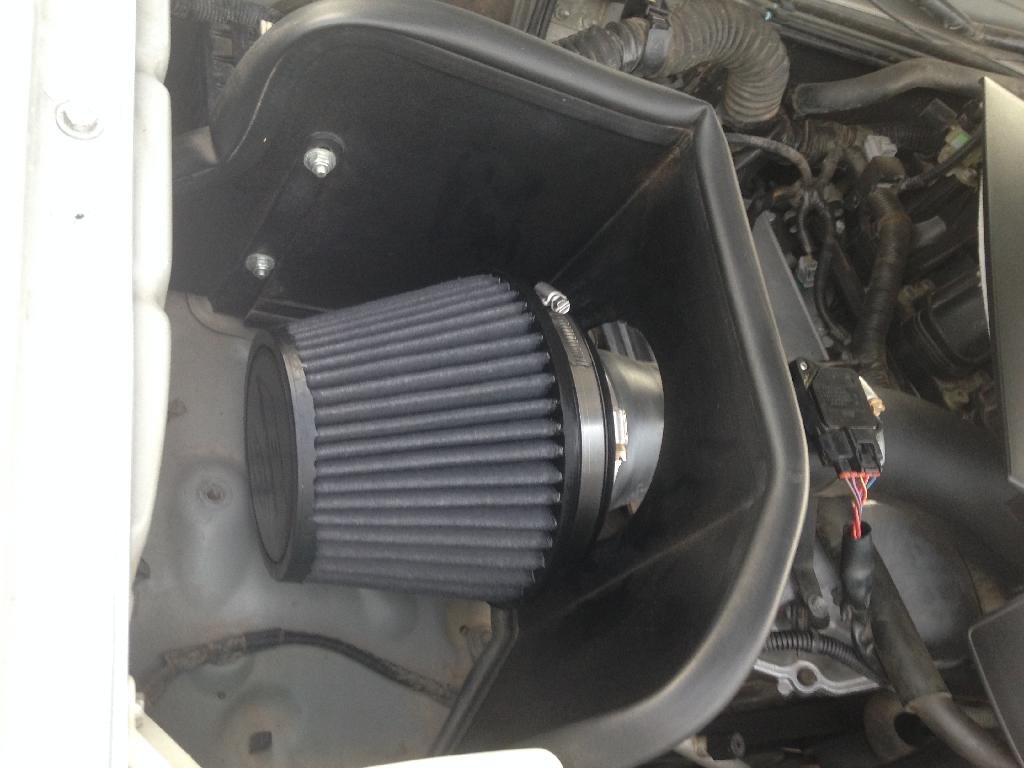

    Replaced my oiled k&n intake with an AFE DryFlow Filter. Less flow but way more protection. Fits perfect on my K&N intake.

    I think sdhq sells pre-filters

    Outerwears filter wrap works great. $20 no more dust on the K&N after trails.

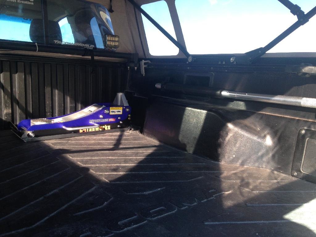

    this vs a hi lift jack? can i get some input, i need a jack but don't know if to go with one like this or the hi lift kind jack

    do you have sliders? or a place to lift from with a hi-lift? If not then this is awesome.

    I have had sliders for a while and I used to have a hilift jack but I don't like how unstable they are even with the offroad base. Got rid of the hilift and got this. Much more manageable and I don't feel like it will kill me. I know it would be a good idea to get some jack stands to throw in the truck though but if this jack fails, I got the extended warranty so I can just bring it back to harbor freight and get a new one. No problems at all with it though.
    That and having longtravel, it makes it difficult to fully droop the front out enough to get the tires off the ground. I would have a shit ton of weight teetering on a highlift. Last I tested it, i didn't feel comfortable using it and it wouldn't even get my tires off the ground.

    With your truck, I'd recomend this since your truck is tall with spindles. It costs more than a hilift setup but I trust it quite a bit more. I've seen hilift jack smash doors when they fall and even the mechanism completely fail and reverse jack themselves down on their own. Ask Sebastian how he likes hilifts, his fell and smacked his head and chipped his tooth!

    I definitely get why your rocking the jack. It makes sense. I agree without the base those hi-lifts are sketchy at best. I prefer the hi-lift for the front just so I don't need to remove my skid to get it all lifted. Hope that helps you Dan.
