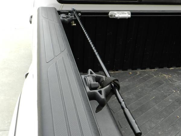

    Well, finally getting around to doing this. Have had stuff for months and a bad case of procrastination with a dose of evershifting project priorityitis. Anyway, doing the center console thing on mine. Got the control box in place on back of console and wire run to door frame. I need a longer coax cable to hook up antenna, connect pwr / grnd & hook up quick disconnect on ground wire for antenna so it can ride behind the seats until needed. Don't want it slapping garage coming in and out since it has the adjuster on top. Not sure if I'm gonna stay with the fold-down option like in the pic below..............

    i wonder if this would work.. mounted to the box of the truck.. with a grond wire ran to the chassie??

    Should work, that's what I'm doing with mine in the pic above. I'm using a quick connect too so I can disconnect ground from antenna and put it in the cab behind seat when not in use just leaving the coax and mount in place in bedrail.

    why not leave the coax and run it under the truck?.. but do you have a actual ground going to the truck.. not just the antenna coax to the cb... for good single you need a base to bounce off of?

    In that pic, the coax hadn't been run yet. The coax going from the cb in the cab to the mount will stay in place. The ground wire coming from the antenna to the frame is what has the disconnect on it so the mast can go behind the seat when not in use. When antenna is in use it will have ground going to frame. The signal will bounce off the roof of the cab and or hood. Not the best for every direction maybe but good enough for my uses. Won't be trying to pull in people 20 miles away or halfway around the world but should be plenty to pick up the weather bands and talk 5 miles away or so.

    thats the info i was looking for.. thanks alot.. ill just run the grond wire with a lil slack just to make the bend.. or im thinking of making a bracket to run between the cab and box.. to go up over my trifold cover.. im going to install the cb and i have a inline booster in the center storage
