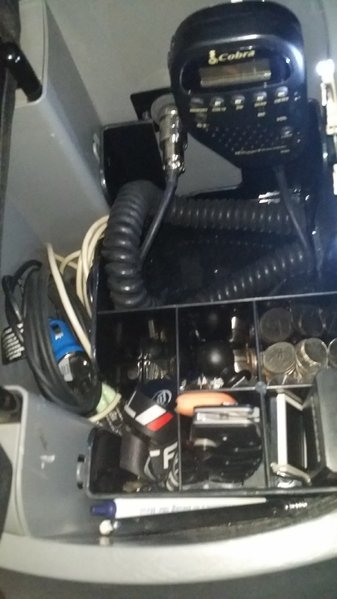

    Hey guys so I did this install minus the mic thing which I'll prolly do.
    Question tho, what did you guys use to hold all the stuff that used to be in there? I bought a sweet tub thing but it's 1/4 too wide but was perfect height.

    14,636
    08 RC Prerunner SR5
    Bar caddie thing........one of these with big opening towards back of console....
    Trimmed it for mic cable coming in back of console.....before that it was chaos............
    now it's organized chaos...............
