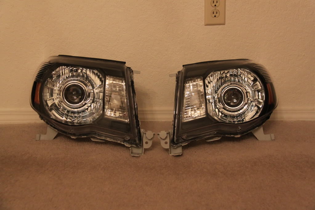

    I was troubleshooting an issue today and noticed my HIDs have burnt or melted a V shape shadow in the chrome back of the headlights. I just replaced the bulbs and had never seen this before. Note the dealer replaced my headlights this summer as the DTRL lens was melting.
    Have any of you seen this? This sucks because the headlights are almost new and my truck is out of warranty.
    HID stats:
    - 55w
    - 6000k
    - Bi Xenon
    As you can see in the pics the "burn in" shadow is the same as the light pattern.
    Lights on:
    Lights Off:

    retrofit them!!! halogen reflector style housings where not designed to accept xenon lights period. they will eventually ruin your headlights plus they are hell on other motorist when they are not done correctly. a true retrofit would not only stop this but it would give tremendous light output while doing it safely.

    Completely agree. Retrofits aren't about "what you can afford", but what is right to do. It's not pleasant to come across a PNP on a dark and stormy rural highway.
