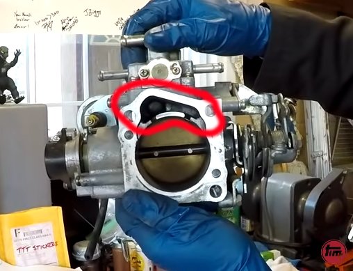

    I'm having this warm idle 1500 RPM issue now after cleaning my entire intake system. My truck has always idled around 1000 RPM warm.
    So I just took my plenum off to re-torque my valve covers cause there was some oil on top of them. While doing so I noticed a lot of oil build-up in the plenum & some on the throttle body. I took everything off and cleaned it really well with throttle body cleaner. I'm now starting remember that I didn't check the lower section of the throttle body that has the small cavity/plenum for the IAC.. I remember it being dark in color down there. Pretty sure there's a bunch of gunk I didn't clean up out of this. I'm going to take the throttle body off again and clean that cavity out.

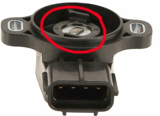

    Has anyone cleaned this area out? Does the interior valve or throttle position sensor that is turned by the electronic actuator on the sensor need to be cleaned/lubed as well? Can the throttle position sensor be cleaned/lubed?

    Check the throttle body if you’ve already tested all known components with issues-idle air control valve, throttle position sensor, engine coolant temperature. I replaced my throttle body with an oem that had all new components and it finally fixed my high idle. There isn’t too many vacuums to check so that should be easy, try pulling on the throttle linkage and look for a change in idle, if so, probably worn linkage or butterfly. there are places that rebuild the throttle body, or just buy the new one which is what I recommend, it comes with new iac valve, new tps, dashpot, and vacuum for the tps.

    There ya go! You was one of the lucky ones, if you price the oem iac, the tps, and the vacuum/dash pots it costs about the same as the new oem throttle body, also the linkage and butterfly do not leak, I could drop the idle 300 by pulling the linkage towards the front of the engine, and for a 23 year old truck-why not.
