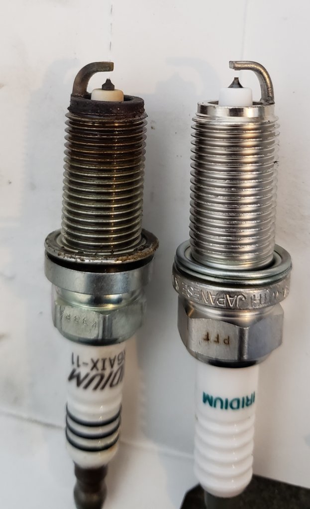

    Yesterday while driving to Trader Joe's it started sputtering and running very rough. After a few minutes I got the CEL light with traction control disabled. I scanned the truck and I got the dreaded PO306 code. On the way home I grabbed an ignition coil and plug from Advance and limped home to the garage. Today I swapped #6 coil pack with #4. Took a little ride and the PO306 code moved to #4. I swapped the coil packs back, and put a new one in along with a new Denso plug in #6. I also cleaned the MAF sensor. Runs great, CEL off, and codes cleared. Attached is a pick of the plug i pulled today. It was dry and the gap at 0.46ish. the new plug is next to it for comparison.

    Iridiums are fine. I'm on my second set and on original OEM coils. I think it is the coils giving you the problems. You can confirm by swapping out two of the ones with codes, with the remaining two that have no codes, #s 2 & 4. If the code follows, you know it is the coils causing the problem.

    Seems to me the shitty parts store coils are you issue (they have all lasted 1-3 years), put OEM (from a known dealer or legit supplier, not Amazon/ebay) ones in and don't look back. Also the stock plugs are copper (Denso K20HR-U11), supposed to be changed every 30k but many people run them well over 100k with no issues.
    OEM coils don't fail often but aftermarket ones fail all the time, I don't get why the first thing so many people do when they have a misfire is replace all their good OE coils and/or injectors (that there's probably nothing wrong with) with garbage instead of properly identifying the cause of the misfire the first time and fixing what's actually bad, it's usually much cheaper in the long run than throwing good money away on bad parts. It may be fine to get you out of a jam when nothing else is available but otherwise not a great idea.

    @Chuy, the code definitely followed where I moved the "bad" coil to. That helped me pin it down this time. My frustration comes in with how often it happens. Kinda like my old Toyota SR5 long bed 4-banger. Every time it rained I would be changing out a bad distributor cap and coil, but the dealer never could ID a reason why. And as for the life time warranty coils, I was spinning my wheels at AutoZone. It wasn't worth the fight.
    @Dm93, thanks and agreed. The first time I swapped them out I did the, "they've been on there a 100k...must be time to change 'em" dance. Pretty dumb for sure. On the OE plugs, the service advisor at the dealer said they generally didn't change them until they hit 100k (Temecula Valley Toyota in CA). After this go-around I'm going to do some cleaning and then switch back to all OEM and go from there.
