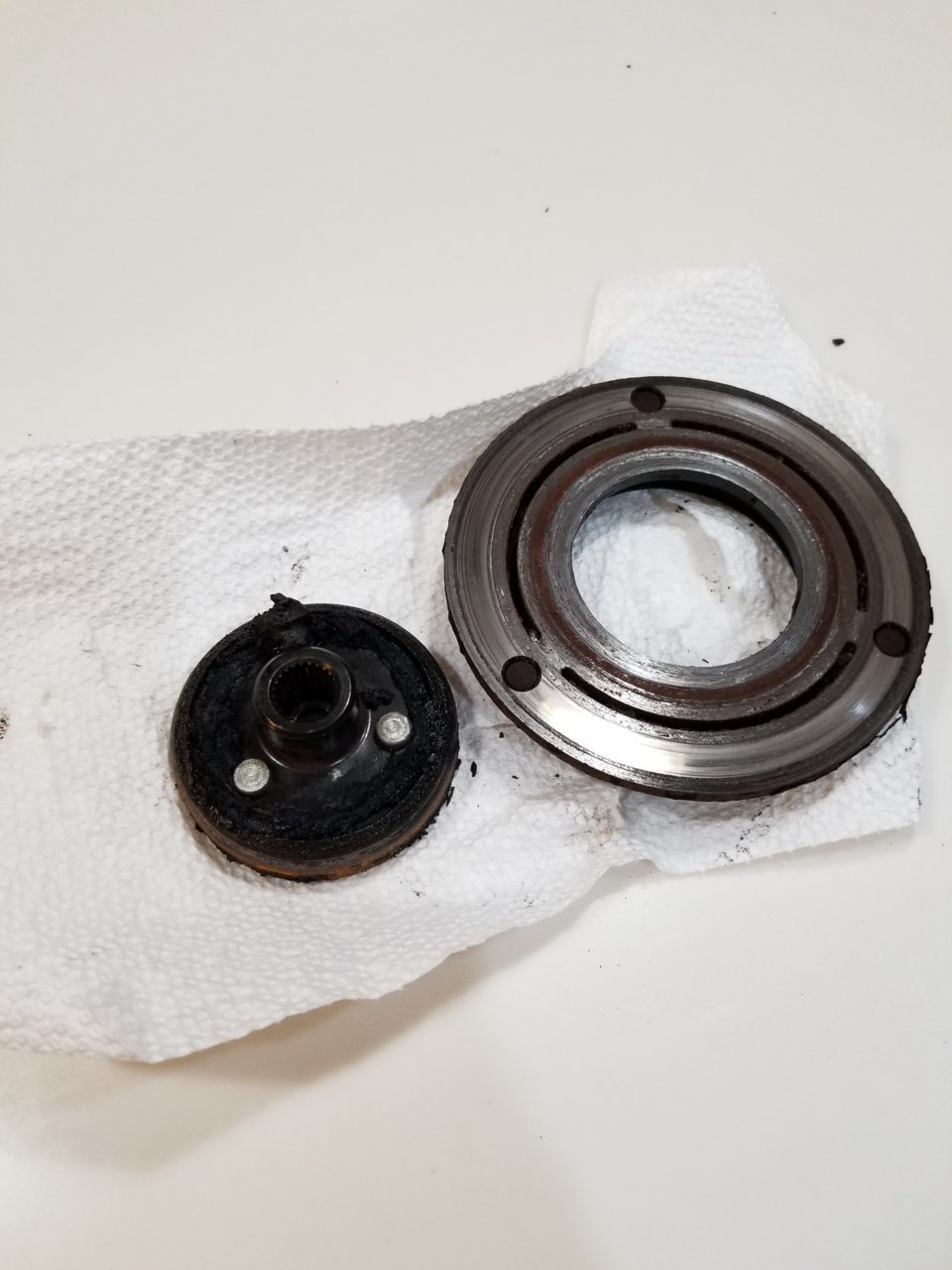

    I am happy to report the clutch hub replacement did the job! Old clutch hub was in 2 pieces. AC kicked on and off without a problem multiple times. 50 dollar diy fix vs 1000 dollar shop quote ftw!20180519_202754.jpg
