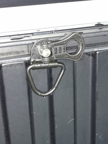

    Not really home made cleats... but was this what you were thinking of?

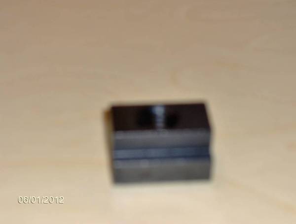

    Go to granger or fastenal and get TECO part # 41406 T Slot Nut 38/16 X 9/16. I bought some, 5 were less than $20 and I had them within a week. Then go to home depot or lowes after you get them and find either rings or hooks or bolts, whatever attachment you want that screws in them and you are good to go...
    I put a couple of o rings on some and made a mountable box with the others. Pretty handy and relatively cheap. and my actual bed cleats are safely locked in my truck.
    one tip, spray them with WD-40 because they can rust.
    I'll post some pics soon as they upload.

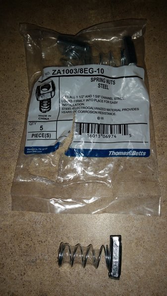

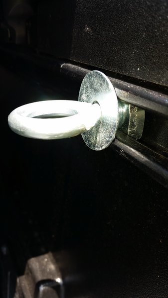

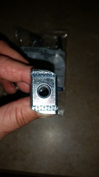

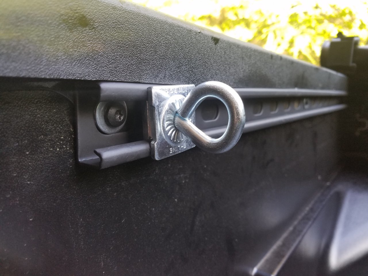

    3/8" × 2.5" eye bolt, 3/8" fender washer, steel spring nuts (found in the electrical section at Home Depot). Place the steel spring nut in the channel, put the fender washer on the eye bolt and thread. The steel nut will angle a little in the channel when tightened. Very secure, unloosen to slide where you want it in the track. The spring gives the nut a little tension. Far superior to the stock Toyota plastic. Should work awesome!

    Thanks for the tip & picks, gonna try this...

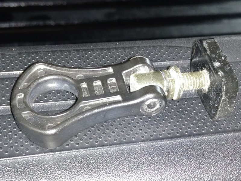

    I modified some 5/8 carriage bolts for a Male attachment point, I use the T-nuts for somethings as well.
    Angle grinder + vise makes easy work of them.
