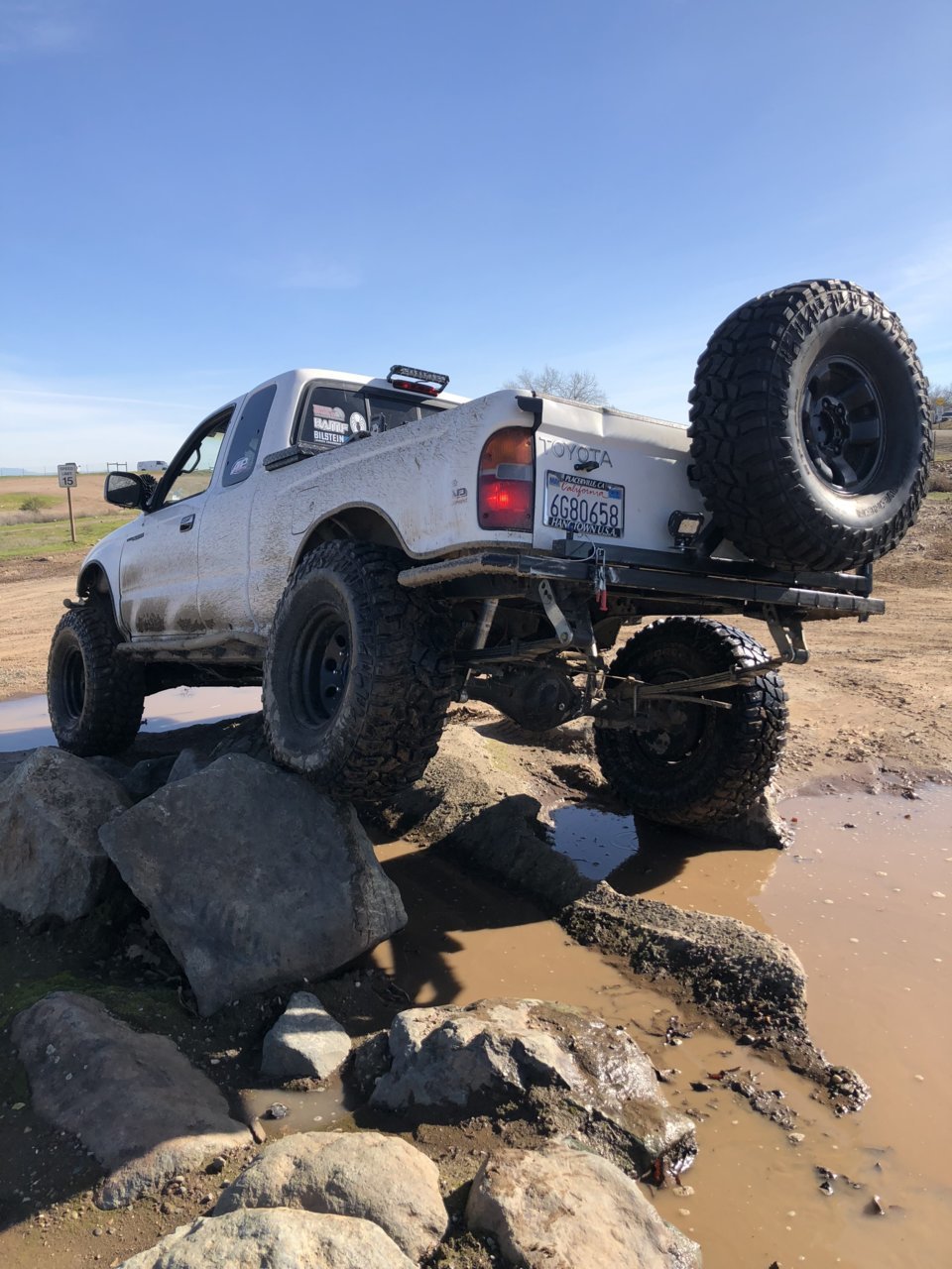

    I built my own swingout for my truck after I bobbed the bed.

    yo, what stuff did you use to line the body panels after cutting? Looks clean.

    I believe it’s called trim lock. It was given to me from a friends work.

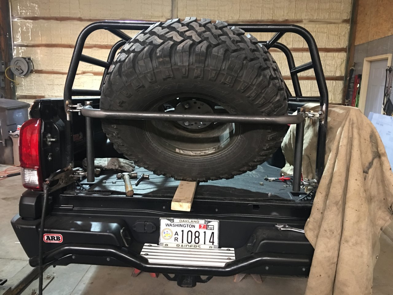

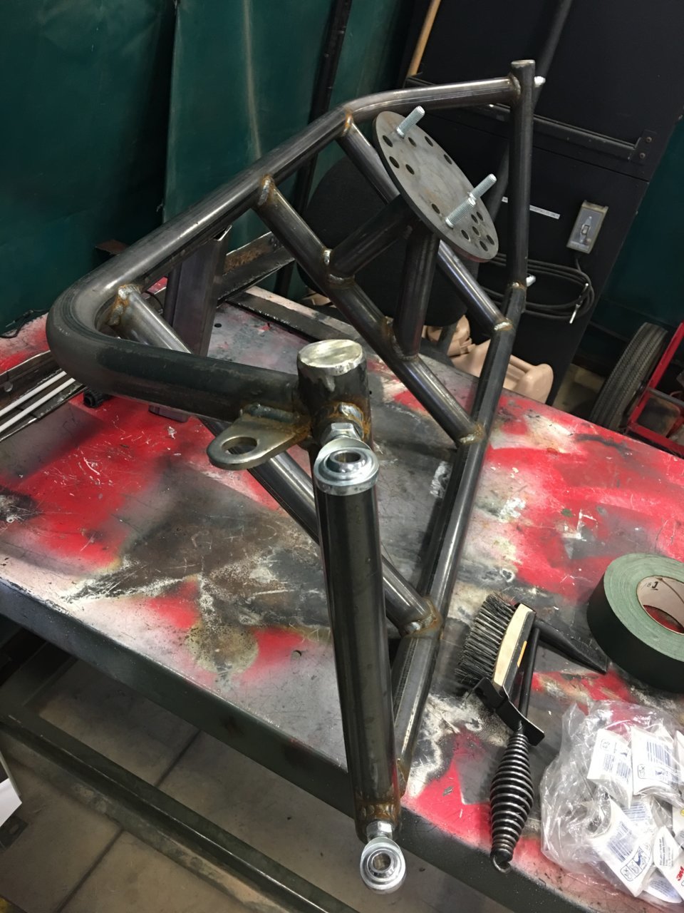

    Working on one now. But mounts to my bed rack.
