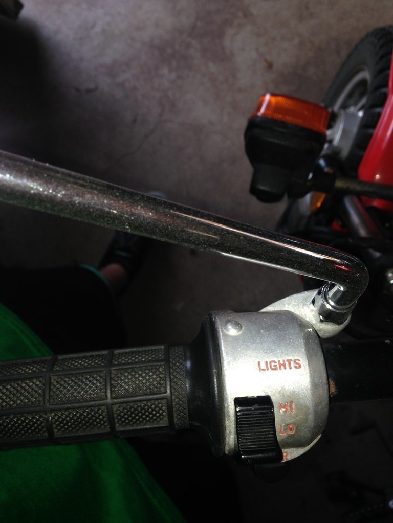

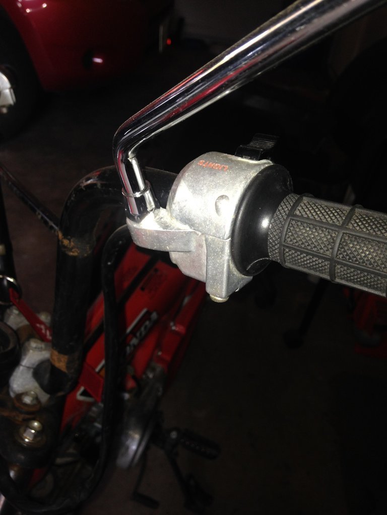

    Here's some pictures of my handlebar. I'm not really sure how to go about adding a clutch handle here.

    Separate the switch and grip and place the couch lever in between them. I think I may have a clutch lever that would work if you want it

    You mean slide the switch assy in and install a clamp on clutch between that and the grip? I found this:

    Exactly except the link you posted is just the lever not the clamp kind. You need a lever and clamp together

    Didn't I post what I would clamp around the handlebar? Then the lever goes on it separately

    My bad didn't see that. Yup that should work
