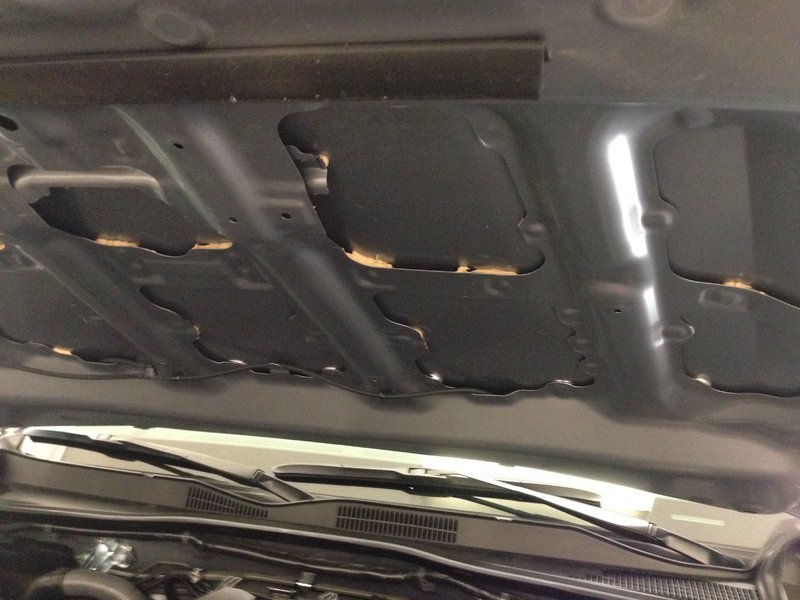

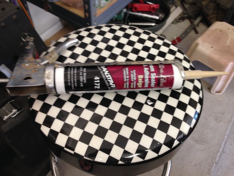

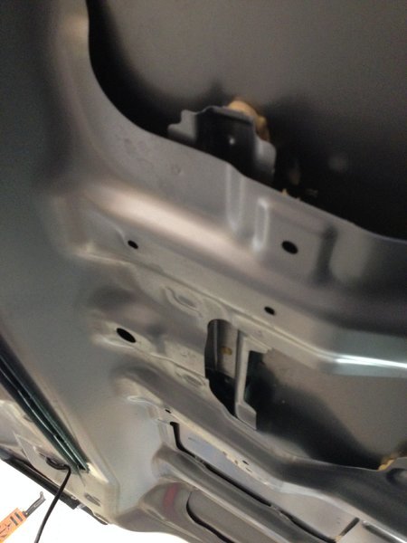

    I used a caulk gun to squirt the seam sealer in every location that was loose. An hour later I painted over the visible ones with touch-up paint. On my truck, most of the vibration was toward the front in the area of a horizontal cross-bar. All those tacks from the factory were loose along with several others. The acid test - I took it out on the highway up to 75 mph and no more vibration :bananadance:. I got the sealer at O'Reilly's but you can order it on the internet for a few bucks cheaper. It's a shame that I only used about 1" of the tube contents but the problem's resolved.

    Quick question on the hood adhesive issue. My truck is about a month old and Texas built. The material between the frame and the skin is the consistency of a marshmallow. Is that what they've always used, or is this new? I do see a slight flutter in the hood at freeway speed but material does not seem to be separating.

    I was told by a buddy that owns a paint and body shop that excessive vibration from the hood can cause paint to crack prematurely. and yes, the adhesive does have the consistency of a marshmallow or actually a bit more like a taffy...

    Its the same construction/material as seen on 2nd Gens. Toyota bolted skewps to most second gens, it acts like a gigantic panel stiffener. The long flat hood on ORs or SR5s makes the vibration more prevalent. The giant bass mouth grill in the front doesn't help either I'd guess.
    But I've compared the hood on my 05 2nd gen to the 3rd gen hood, both are constructed the same (as far as that taffy/adhesive goes).
    The story goes is that adhesive is only needed as a partial step for Toyota manufacturing when they create the hood. I'm guessing its to help hold the understructure of the hood to the actual hood skin, but I'm only guessing.
    If anyone is really interested in fixing the flutter/vibration they should go back and read this thread from page 1 and use the correct NVH material to fix it. I've posted as well as other members on a solid fix for this situation.
