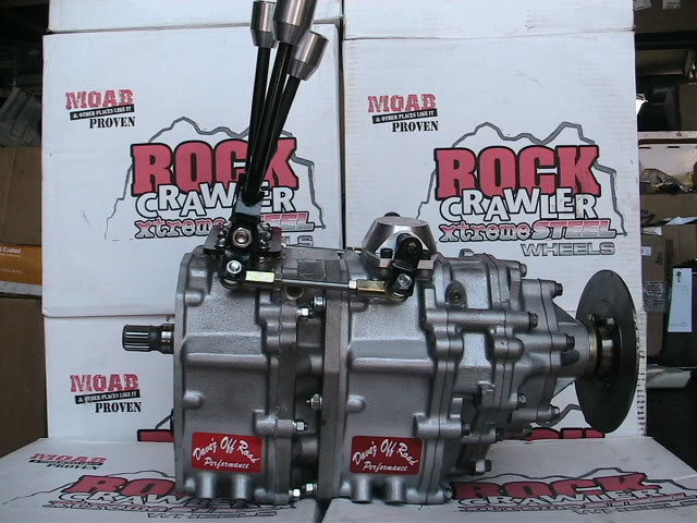

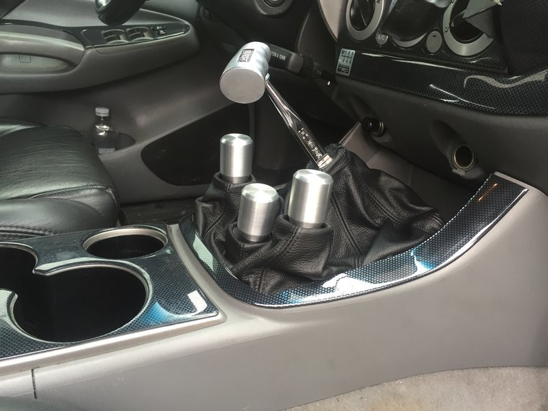

    After a few back-n-forths with @HomerTaco, I think I'm going with the triple shifter from Davez.
    https://www.davezoffroadperformance.com/store/drivetrain/transfer-case/parts/triple-shifter.html
    For one, I plan to eventually add a crawl box. I can reuse it later.
    I think I can modify the forward base plate...
    (This is where the sticks connect and pivot from in the first pic.)
    ...that goes around the crawl box lever to fit around my transmission shift lever, and then secure it to the riser for the short throw shifter already installed.
    - I just realized I took exactly zero pictures when I installed my short shifter so here's one from Google that may or may not be just like mine but is close enough for this post. Obviously my truck is not red. -
    I really won't know until I see one in person so I can get hands on with it. Going off of the pictures I don't see why it wouldn't work.

    Repost from my PM:
    Anything is possible with enough fabrication but consider this: the triple stick base is meant to mount on a crawl box with a shifter that only goes forward and backward. The trans shifter has a much larger range of motion. Also the bolt pattern for the crawl box shifter is radically different from that of the transmission shifter.
    When only doing an FJ case swap it is possible to have the twin sticks come up to the right of the trans shifter by making extensions on the sticks.
    The triple stick linkage is needed with a crawl box because it pushes the FJ case back another +8”
    I think you’re actually making it more complicated than it needs to be for just an FJ case swap. ;)
