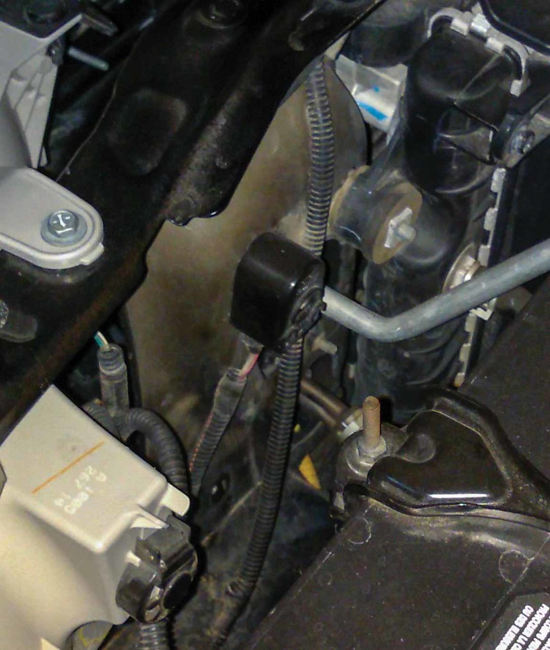

    Did you make sure your beeper was plugged in? Maybe previous owner unplugged it. There's also this but I don't know it it works or not.

    My switch to kill the "beep" in case of needing the four-ways is different now but I'm still running this mod.

    Pioneer head unit, PAC steering wheel control modual, Hard wired Sirius radio, Hard wired radar detector, Hella Supertone horns, Blacked out badges, Smoked Tails, BHLM (color matched Speedway Blue), T-Rex Eyelids, Black Powder Coated Billet Grill, Color Matched Engine Cover, Lund in channel vent visors, FJ Cruiser wheels, Leer 100XQ shell, OEM bed mat, Piezo beeper for locking doors, Tinted front side windows, Black Westin bull bar, Aires tube steps, Mini Maglite Mod, D-Cell Maglite Mod, Weathertech Digifit Floor Mats

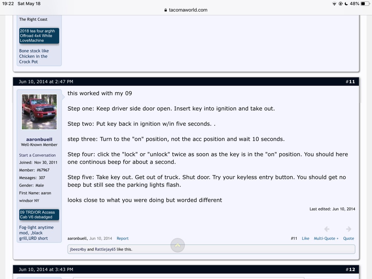

    I just disabled my beeps and it's actually pretty nice. It's so annoying with all the beeps to get in the truck. I have a family of 5 so I often have to double hit the button to unlock all the doors which gives off 4 beeps. Now it's quiet. :D
