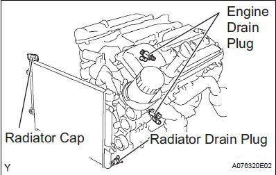

    I tried changing the coolant myself but only released coolant from the radiator drain cock. Didn't know there were other release ports. At any rate on 2.5 quarts came out of the radiator. I've read that there is 13 qts of coolant in the system so the block must retain the bulk of the coolant.

    the last one is hard to get to, i have helped one other do it but not myself yet since most have told me to wait till 100k.
