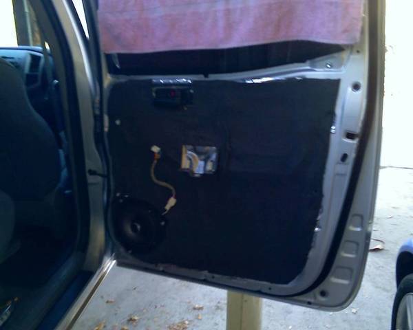

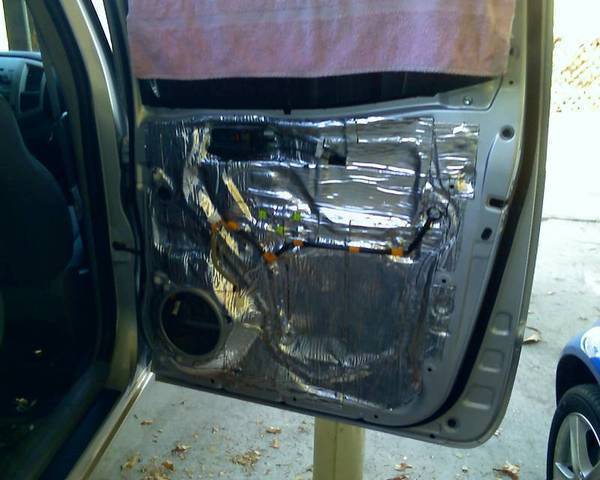

    I used Raammat (TW Discount). I roll (15" x 50 ft) was enough to do all four doors and have some left over for the back area behind the driver's side rear seat. I did the entire inside and outside of the door and I put a double layer directly behind the speaker. I also covered the area inside the door panel with ensolyte (also on the site). Make sure you clean the inside of the door before putting it on. There's a lot of dust & dirt in there.
    Inside:
    Outside:
    Ensolyte:
