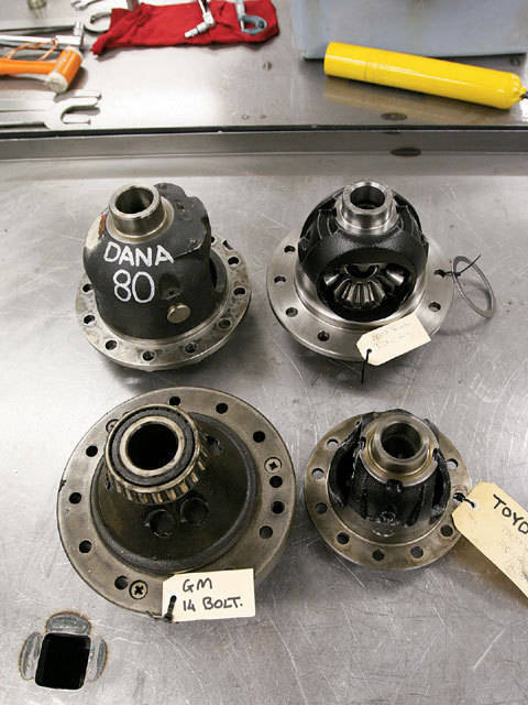

    Clockwise from top left: Dana 80, 07-09 Tundra, 00-06 Tundra and GM 14 bolt. You can see the massive difference between the early and late Tundra differentials.
