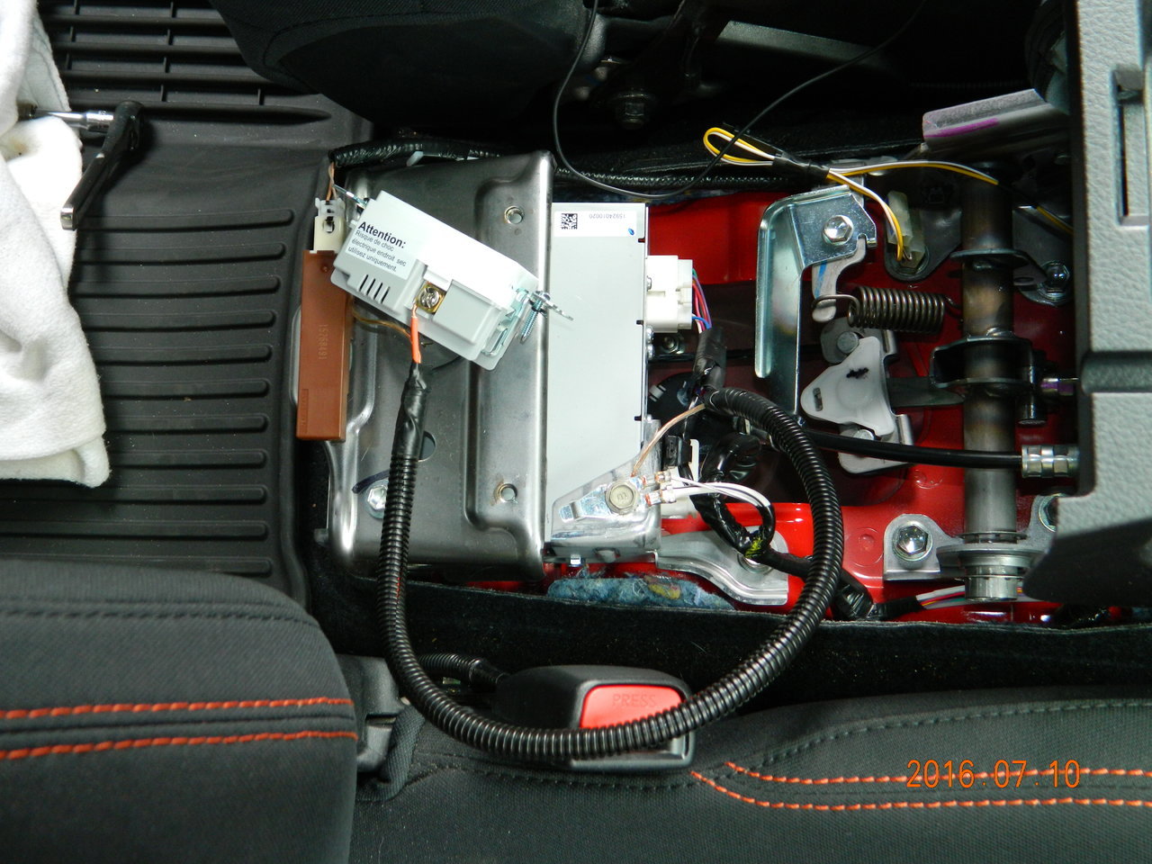

    I had hell trying to reach the grounding spot in the pic. I ended up using a different part of the parking brake and it is a moving part, so I'm a little worried about it wiggling free or breaking the wire. Any tips on reaching that rear mounting bolt?
