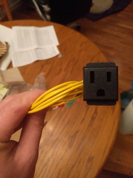

    Great write-up! I did the 400w anytime and added an AC plug in one of the switch blanks.
