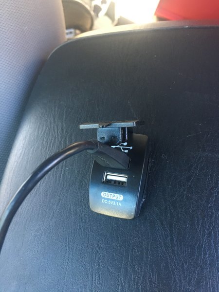

    In a bind and need some help. I realize this is an ac mod but I need to find D.C. Power in the same vicinity if possible. I have a dual USB DC plug I would like to use. Where can I tap into this?
  17. Feb 6, 2017 at 5:38 PM
    #517
    road2cycle
    road2cycle Well-Known Member
    Apr 11, 2016
    #183973
    531
    Sonoma County, CA
    2014 Tacoma DCLB 4x4 Limited
    If the input to that module requires 12Vdc then I believe your two closest choices are:
    - The DC input to the AC inverter module (it will be a very thick wire and might not be too easy to tap into)
    - The cigarette/accessory socket (you'd have to run a wire from the rear of the socket and under the gear shift cover to get to the armrest)
    You could also use an add-a-fuse and run that wiring from behind the coin tray to your USB jack. The current draw would be less than 2A to the USB jack. If you don't want the USB jack turned on when the truck is off be sure to select a switched fuse location.
