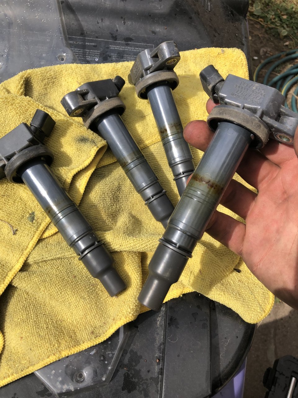

    #156471
    23
    CO
    '10 2.7 5sp 4x4
    nice write up. 142K on the original plugs. Would a valve cover gasket failing cause that staining on the coil packs in the second picture? No other signs of oil leaking around the valve cover or the tops of the packs.
