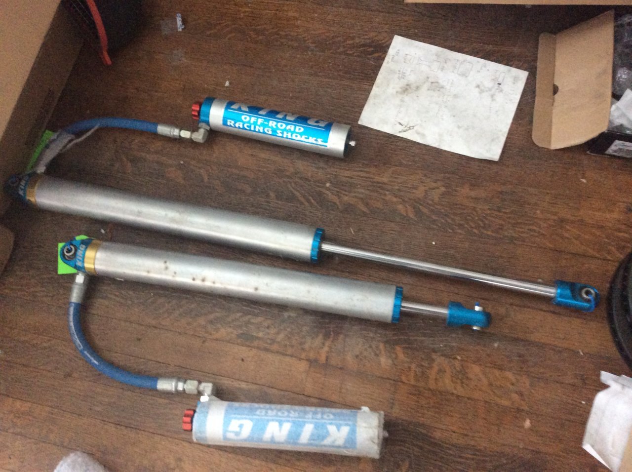

    Cool yeah they are 2.5's. They are still on their way here, but I can measure for you when they show up!
    I will figure it out from what they have at the junk yard anyway! At least I know that the shock won't be the limiting factor!

    Link to the shocks you got so I can compare them to the smoothies.

    Yeah they are smoothies, but with IBP.
    Edit: Here's a picture:
