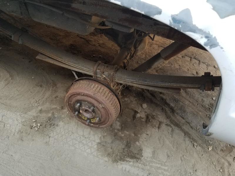

    These should be good, am I correct? They are out of a 93 SL.
  20. Mar 26, 2024 at 9:26 PM
    #1120
    Shadowhunter
    Shadowhunter Well-Known Member
    Mar 24, 2017
    #214241
    4,267
    Nate
    Birdsview Washington
    13’ DCSB MT Sport
    Front and Rear Locked, 35’s, Chevy 63” swap, Fox Suspension and a bunch of other shit too long to list.
    Those look right. Full
