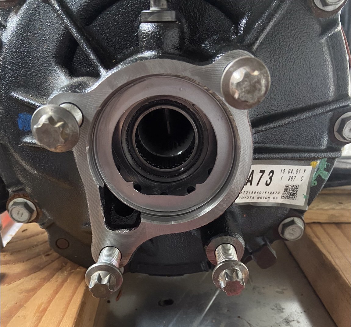

    Here’s my diff after pulling the ADD stub out. This is a 2015 4Runner front diff and from what I can tell it is the same as a Tacoma front diff. Do I need to remove the metal retainer as well or can I just bolt the non ADD shaft/tube to the diff? It looks like it is just pressed on there. Is this an oil baffle that was added on the 5th gen 4Runner diff?

    I wrote a bit about this in my ARB install DIY. https://www.tacomaworld.com/threads/front-arb-air-locker-diy-install-thread.692979/
    As long as the non-ADD part fits without contacting this, and I assume it should as now it's just a straight shaft, you can leave it in. It's a retainer deflector that possibly stops over travel of the ADD clutch sleeve and also has tabs to deflect oil from getting into the breather.

    Thanks for the information! I’ll do a quick dry fit before I do final assembly with sealant.
