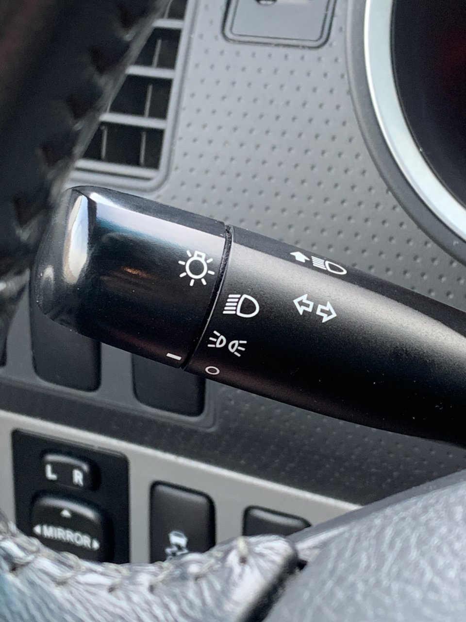

    Want to disable my day time running lights so my turn signal covers don’t crack like they always do. How would I do that?

    They are off.
