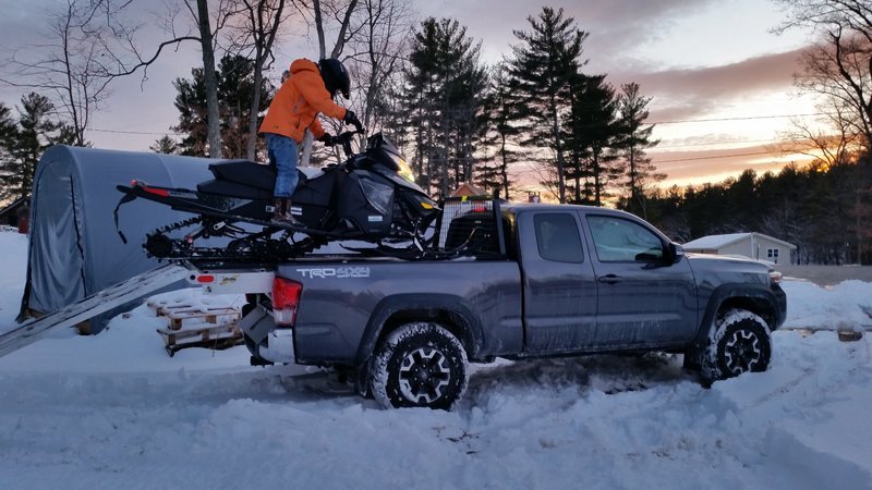

    Here she is under full load, to give you an idea of how the sumo springs sit loaded. This is my completely stock OR except the sumo springs and about 900 #s in the bed.
    nftyper, minium and arnette64 like this.

    F yeah, you look like you are sitting pretty level even with the weight added in this pic, and thats way more than i'll have!
    Nail[QUOTED] likes this.
