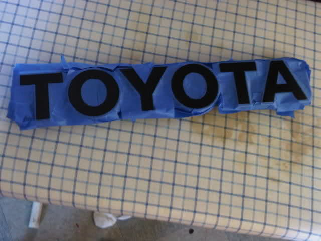

    I just painted mine... (haven't got it on the truck yet)
    1. sand off all the tape/sticker... that comes on it down to the plastic
    2. Paint whole thing the color you want
    3. let dry
    4. tape the whole thing
    5. Use exacto knife cut away excess around letters, leaving only the letters covered
    6. Respray entire thing black
    7. Let dry
    8. Remove tape
    the other way, trying to cover the excess area only doesnt work (tried it).
    here a pic of finished product
    sorry the crappy pic but you get the idea...
    Now I just have to figure out how to attach it... I have 3M tape but I'm not too sure how strong that will be?

    Cool. Thanks for the steps. Hope it was ok using your picture. The 3m tape will be fine. I use it for my badges. Nice strong hold. Post pics when your done.
