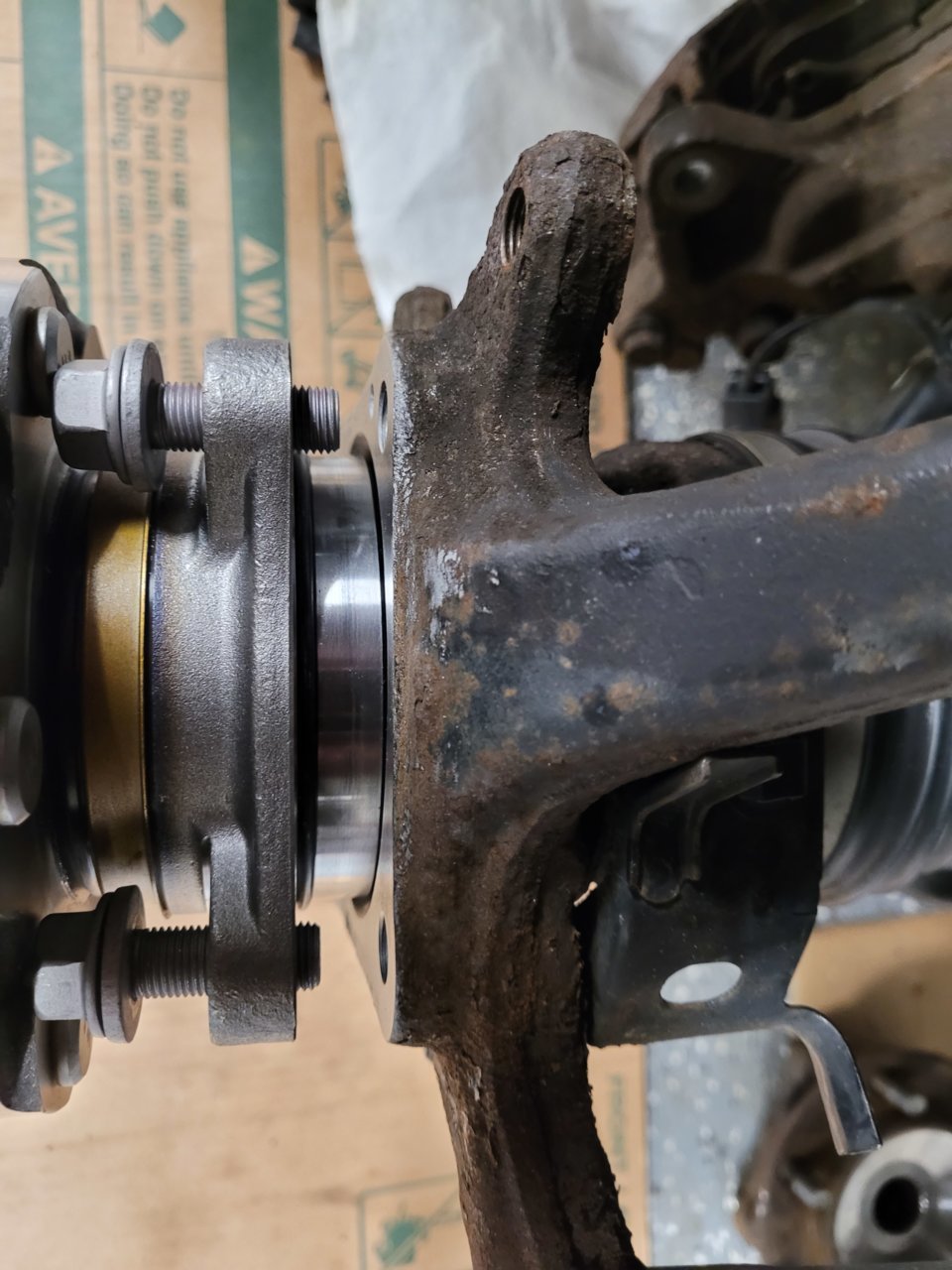

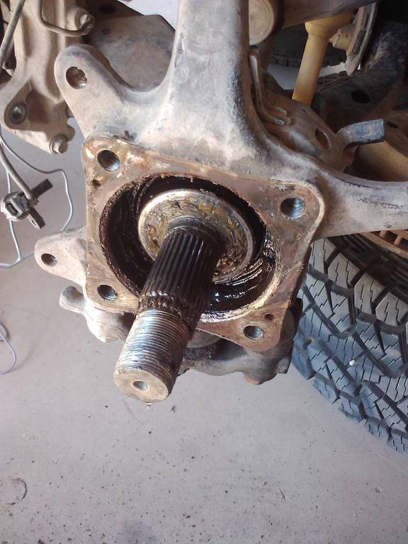

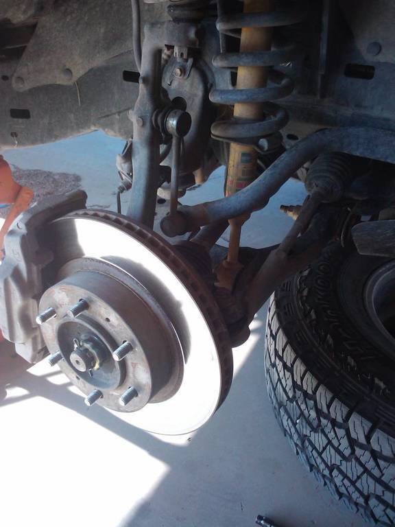

    I am reassembling my passenger side and the new wheel bearing assembly is getting stuck on the axle splines. No burs or damage on the axle or new hub. Axle was free when I removed the original, could slide in/out of the original hub with my thumb when the axle nut was removed.Original hub assembly still slides right on with a light push, new hub gets stuck on axle spines before the machined lip reaches the upright. Short of a messed up new bearing assembly what am I missing? The new unit is Koyo wheel bearing assembly. Left the dust shield off for clarity in the attached picture.
