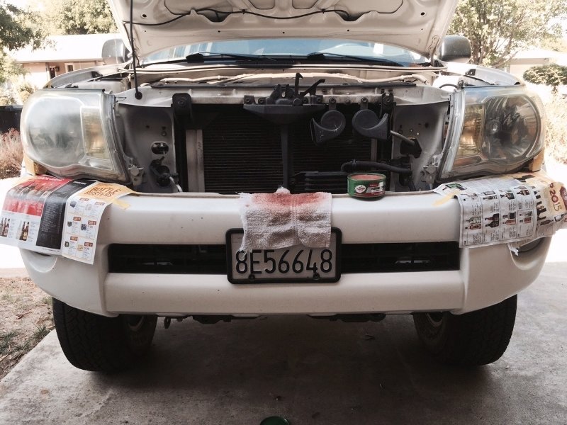

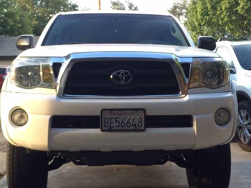

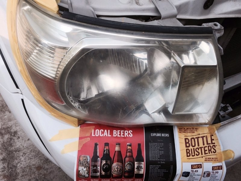

    Bump from the dead- I followed these steps yesterday and the difference is night and day. I would recommend finishing with 3000 grit sandpaper and being very liberal with the rubbing compound. I probably made 5-7 passes on each headlight with the rubbing compound and there is still minor etching visible from the sandpaper. Application of the urethane should also be extremely light, I ended up with some minor runs on my driver's side headlight even though I was being careful. Overall I'm impressed and it's a simple way to breathe some life into my almost 10-year old truck.
    I didn't get any true 'before' shots, but the headlights were embarrassingly clouded.
    Driver's side sanded, Passenger side untouched:
