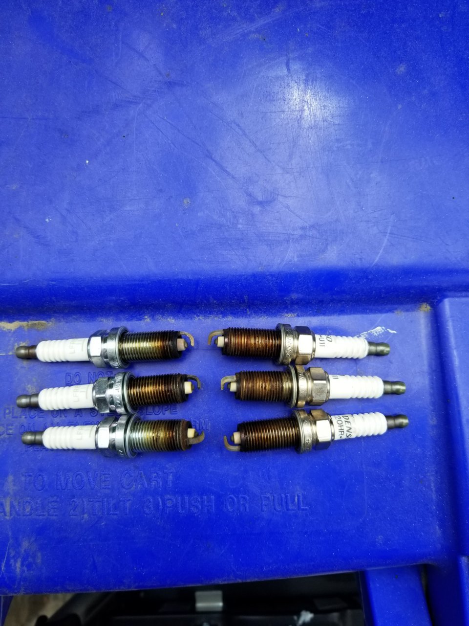

    thought id take a second and give a thanks for the write. Many of us know how to change plugs, but its the little tips, what to remove, etc that make it worth while.
    Id like to add, follow the recommended mileage guidelines for changing, forgot what they are though, 30k i think. I changed many plugs in my life, but never seen plugs so worn down at 70k miles. they were gapping around 0.055-0.06

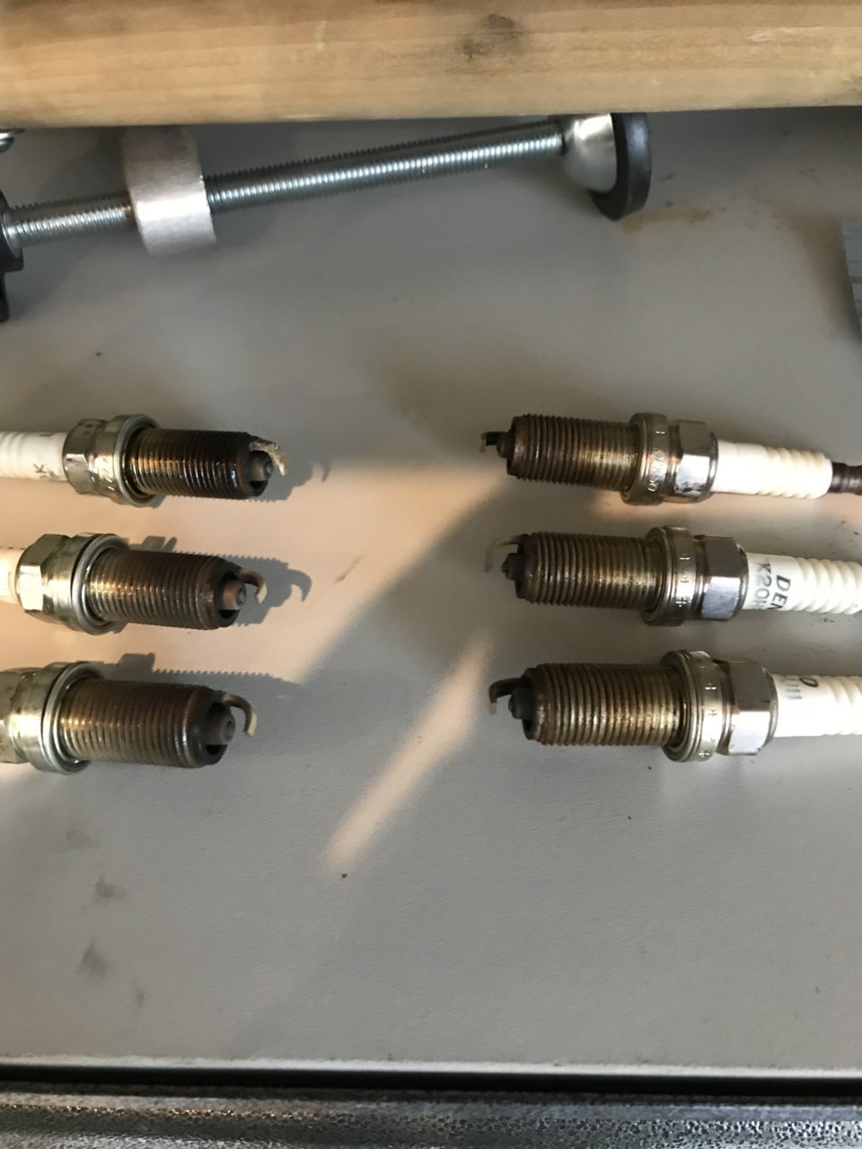

    Replaced mine today, truck has 240k miles and they looked original, NGK on one side and Denso on the other. They came out rather easy with the steps listed here. It ran good before, should run really good now. Also cleaned the throttle body while it had it apart.

    40,175
    :eek:
    Holy crap, there's nothing left! Should make a huge difference!
    From the FSM:
    Electrode gap 1.0 to 1.1 mm (0.039 to 0.043 in.)
    Maximum electrode gap 1.46 mm (0.057 in.)

    :eek: didn't know plugs could last 240K. Did you happen to measure the gap?
  16. Jun 2, 2018 at 2:02 PM
    #2016
    sseaman
    sseaman Well-Known Member
    Nov 28, 2017
    #237176
    72
    Scott
    2007 DC Prerunner DSM
    They were between .085 and .095
