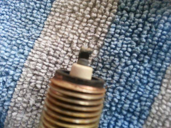

    Sublime
    Sublime Well-Known Member
    Nov 14, 2009
    #25918
    3,422
    Phoenix, AZ
    08 TRD 4x4
    Icon/All Pro.....chopped for 35's
