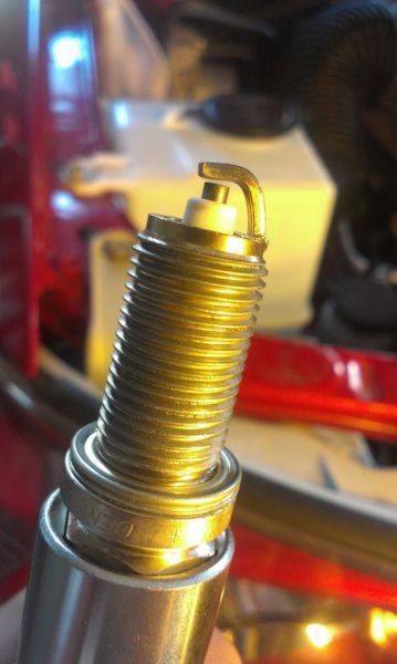

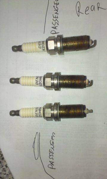

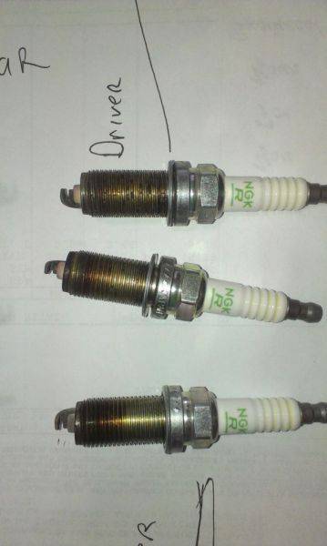

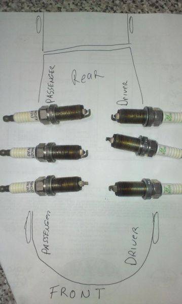

    Changed my plugs out tonight for the first time. Should have done it at 30K, but I did it at 45K. The pic below shows what the old plugs looked like. They all had a brown/burnt looking ring around the top of the insulator just above the nut. Has anyone else seen this? Is it normal or does it indicate any problems?

    Normal, mine were like that and other pics I've seen on this thread are the same.

    Thanks AgentSmith. Good to know it's normal.

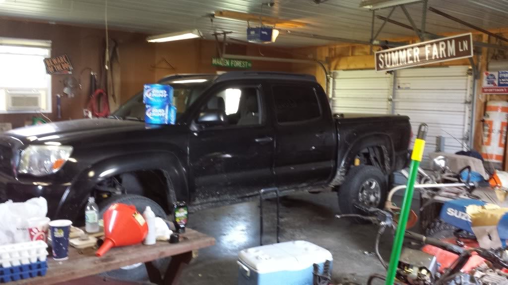

    Awesome write up Chris. I just changed my plugs for the first time and it took exactly 2 hours. The step-by-step instructions and pictures make it a piece of cake.

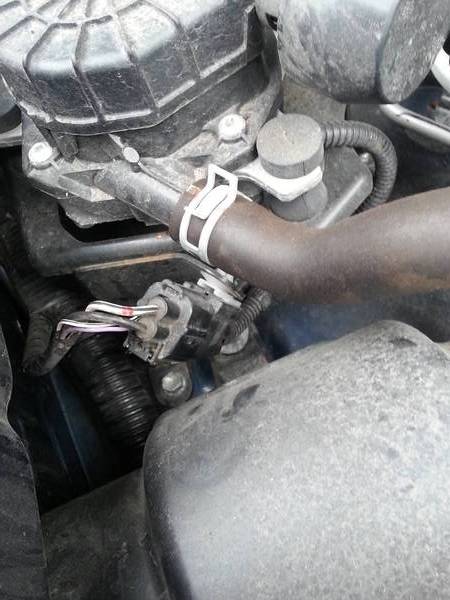

    3. Keep on eye on the spring clamp from the vent hose. I left it on the hose and it was gone when I went to reinstall it. After a couple of anxious minutes, I found it sitting on the valve cover. I suggest taking it off the hose and setting it aside

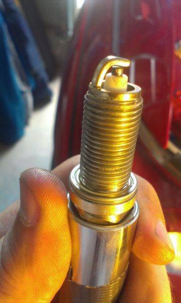

    Thanks for the post, changed my plugs on my 2012 with 52K. Plugs looked decent, NGKs were at ~.053 gap densos were more like .043. Only difference with the 2012 is the air intake is a pain to get off because the 2nd bolt is hard to get to, I just moved it while working and left it on.

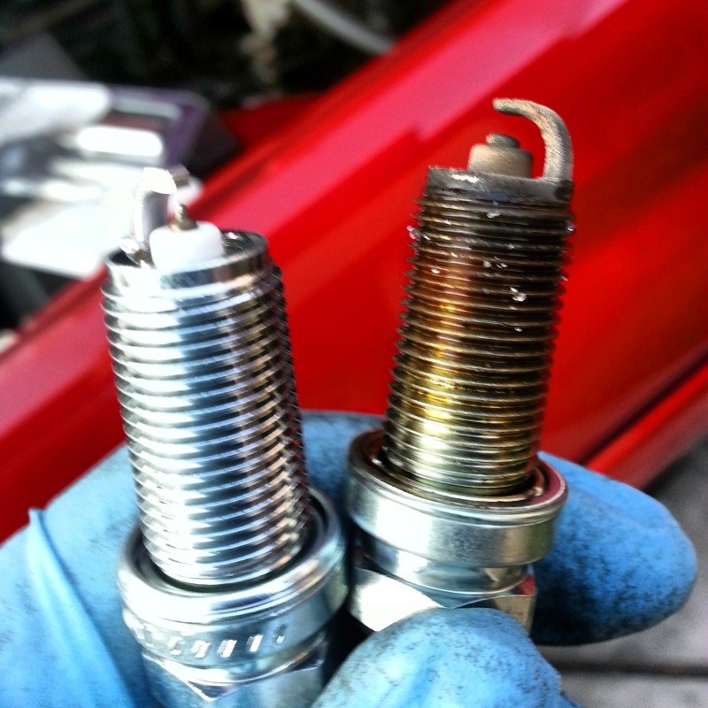

    So changed plugs yesterday and ran great. This morning started and running like shit. Like its misfiring but only when in drive. Not noticeable in neutral or park. Any ideas

    Did a visual inspection... everythings connected. All vaccum lines good to go. Said fuck it and pulled the plugs to check gaps. All at .041 as I double checked them before putting them in.... except this shit! WTF
    Hard to see but the solder/weld on the plug electrode is cracked. Replaced it with a new one and good to go!

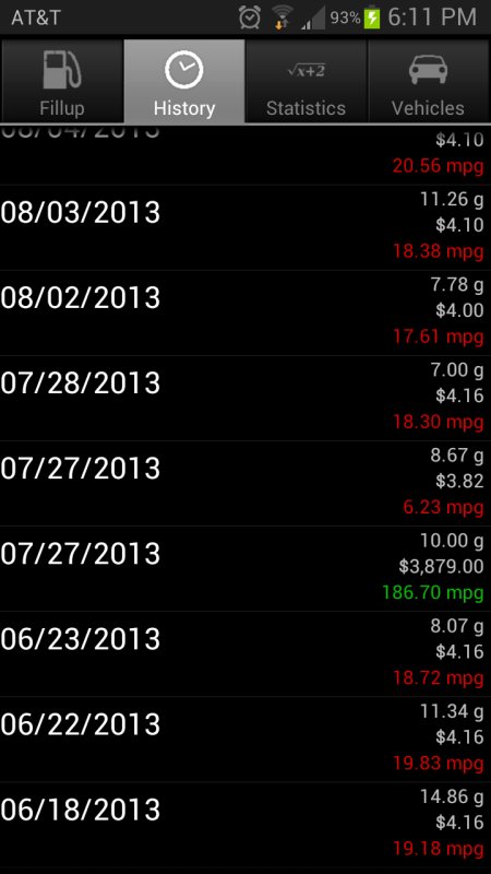

    Got around to it a few weeks ago (July 23rd)... Bought NGK Iriduim IX or something like that. I honestly can not tell a difference. My plugs were the originals with 89K miles on them (NGK and Denso's).
    Gas mileage has been relatively the same (the very high and very low MPG is when I stopped monitoring gas mileage and restarted.)

    Your old plugs actually look quite good - much better than my original plugs did with similar mileage on the truck. How's the gap on the old plugs? The one in the pic looks a bit over, though hard to tell in pics.
    If you didn't disconnect the battery when you changed them out you might not see any difference for a while. Give the computer time to re-learn the engine. If you're looking for MPG gains from maintenance at that mileage, it's worth checking your air filter and throttle body as well as I saw some improvements after cleaning mine out.

    The gap was pretty big in the old ones, That's the one that looked the worse... I didn't disconnect the battery but gave it a few days to re-adjust (~100 miles) until I started checking the MPG's again. The air filter (TRD 1st gen intake) was cleaned not long ago... How ever, I did run it without the filter cover for a while and put it back on the same time I changed the spark plugs so that might be why it didn't get much if any improvement. I'll take it off and run it for a week starting tomorrow and see if there is any improvement. Never checked the throttle body either...
