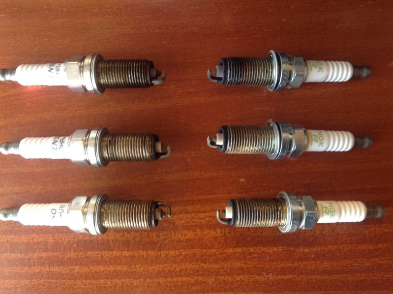

    Don't know where my post went. This are the original spark plugs, changed at 76,000 km. Great post Chris, thanks for the step by step tutorial.
