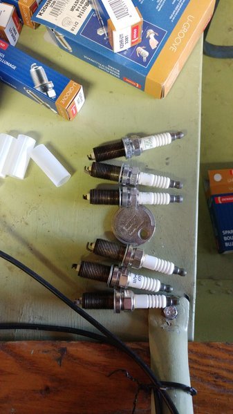

    this post was super helpful. changed mine out for the first time on my own. got tired of the dealership prices for $20 of parts and 1 hour of time.
    160k miles and from what i can tell, no dealership/garage ever bothered to change the NGK plugs on the driver side, just the Denso's on the passenger side. yeah it's a pain, but it shouldn't be an issue for what those places charge. For the first time in it's life we're running on 6 fresh, brand consistent plugs.

    Replaced mine today. 33k on them. Avg gap on the ones I took out was .055

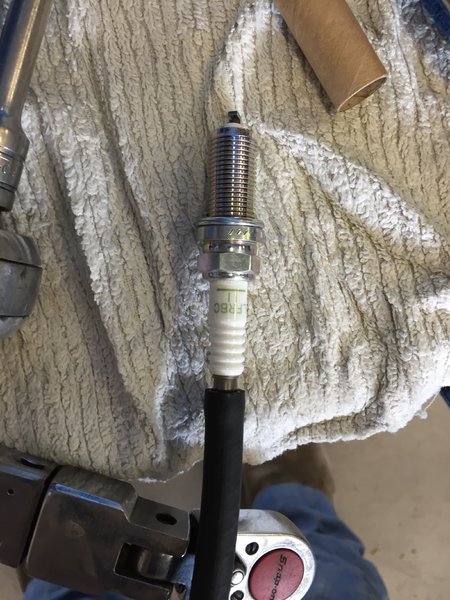

    Changed mine out today didn't have a spark plug wrench so I used a magnet and a piece of fuel line

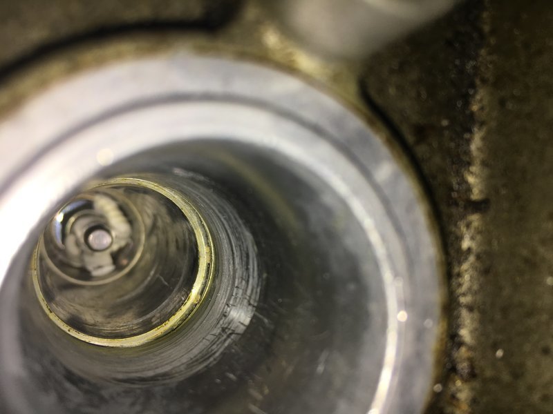

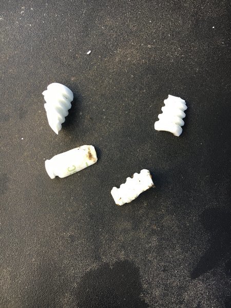

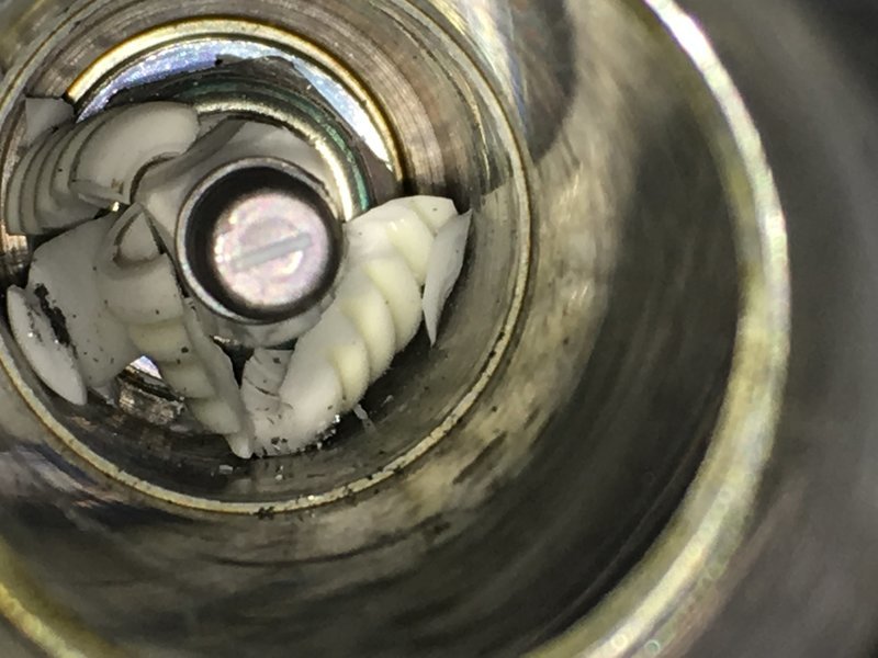

    Decided to change out the plugs yesterday (at 55k) and came across something I never would have expected. I did the passenger side first and then the driver's side (a PITA and, in fact, I had to remove a couple of other pieces beyond what the OP had suggested).
    Anyhow, When I got to the last spark plug I noticed I was having difficulty seating the spark plug socket on the spark plug. I spent probably 10 minutes trying to get the socket on and finally accepted that it wasn't going on. I grabbed a flashlight and took a look and saw what I thought at first was plastic or styrofoam. I wondered what in hell it was doing there, and how it got there.
    The more I thought about it the more I realized that styrofoam and plastic just didn't make sense. I then took my phone and was able to get some close up pics and it was then I realized that it was ceramic pieces. I took an air compressor and was able to blow all the pieces out and replace the final plug.
    What in the world would cause something like this to happen? This is the first plug change. Has anyone else ever experienced such a thing and, is there the potential for damage?

    The only thing I could think of is that spark plug got over torqued at the factory

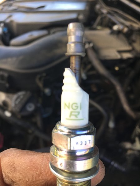

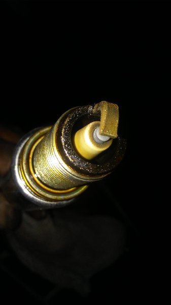

    Just changed mine out after way too long...a little embarrassed to say. anyways, 5 of the 6 look to have normal wear and tear on them (albeit an abundance due to their overuse), but one looks far worse than the others (far left/second photo). On a cross country trip recently, I had a misfire/code on that particular cylinder which i bandaged with a new coil spring to get me home. Wondering, do the condition of these plugs indicate anything additional that I should be worried about/look into? thanks!

    NGK on drivers and Denso's on passenger? That's how they come from that factory. Why they come from the factory like that is anyones guess, but a lot of people on here have reported the same results including myself. Wow, 160k on factory plugs!,! No wonder you now have WHOOM, WHOOM. Bet the truck runs much better?

    OK I didn't read all 93 pages, how do you keep the spark plug from falling out of the socket? Is that a dumb question?

    You use a spark plug socket. Some have rubber to grab the porcelain insulator and some have a metal clip in the shape of a "V".
